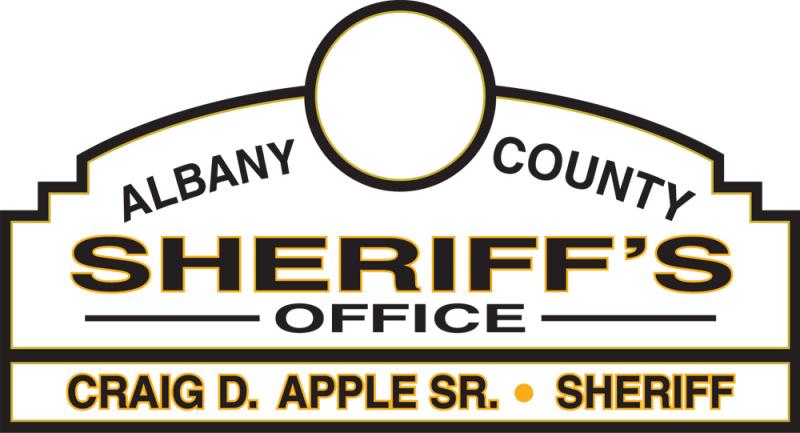

2 coats of primer, killz premium latex. Going to use sherman williams matte black and white paint and Ronan aqua leaf gold. Ronan's Inca gold seems to be the best match to 3m 7125 satin gold vinyl but can someone confirm this for me? Talked to someone at ronan, they said if i mail them a sample of the vinyl they can tell me which is the best match but figured I'd ask here.
I posted about this last week but didn't really get a good answer. First, this project fell into our laps with the artwork posted and no real description of whether the shoulders of the lettering should be white or the color of the letter. This is our first painted 3d hdu sign, so I want to make sure I deliver a good product but I also dont want to kill myself doing so. I intended on painting the shoulders of the lettering to match the letters, ie gold around sheriffs and the bottom line, black on the rest. And I was going to paint the shoulder of the border gold. Now that I'm putting down the primer I realize that I will have a ton of tapping and steady hand painting to do... And that I probably should have had all the text cut seperately, paint it, then glue it on the sign afterwards... So the question for the 3d sign people, will this sign look like crap if i paint the shoulders of the lettering white like the background? Then I would roll on the black and gold paint on the tops of the letters. The text that is balck and gold will be painted gold and apply black vinyl. Thanks for your input. I now have a greater appreciation for sign painters, and even greater appreciation for teh advent of the computer.

I would do letter returns same as background
looks like you already have it routed, but what I do is finish paint all areas that will be raised copy, then mask and route, then paint background, then peel mask and you have a smooth finish to your letters already. then go about applying whatever overlays you need, and done

Yea that method makes sense. I dont have a router though, had it routed by our substrate supplier. If I paint the background and returns white, and then lightly roll on the black and gold to the top of the letters, do you think I can keep it from running onto the returns?
