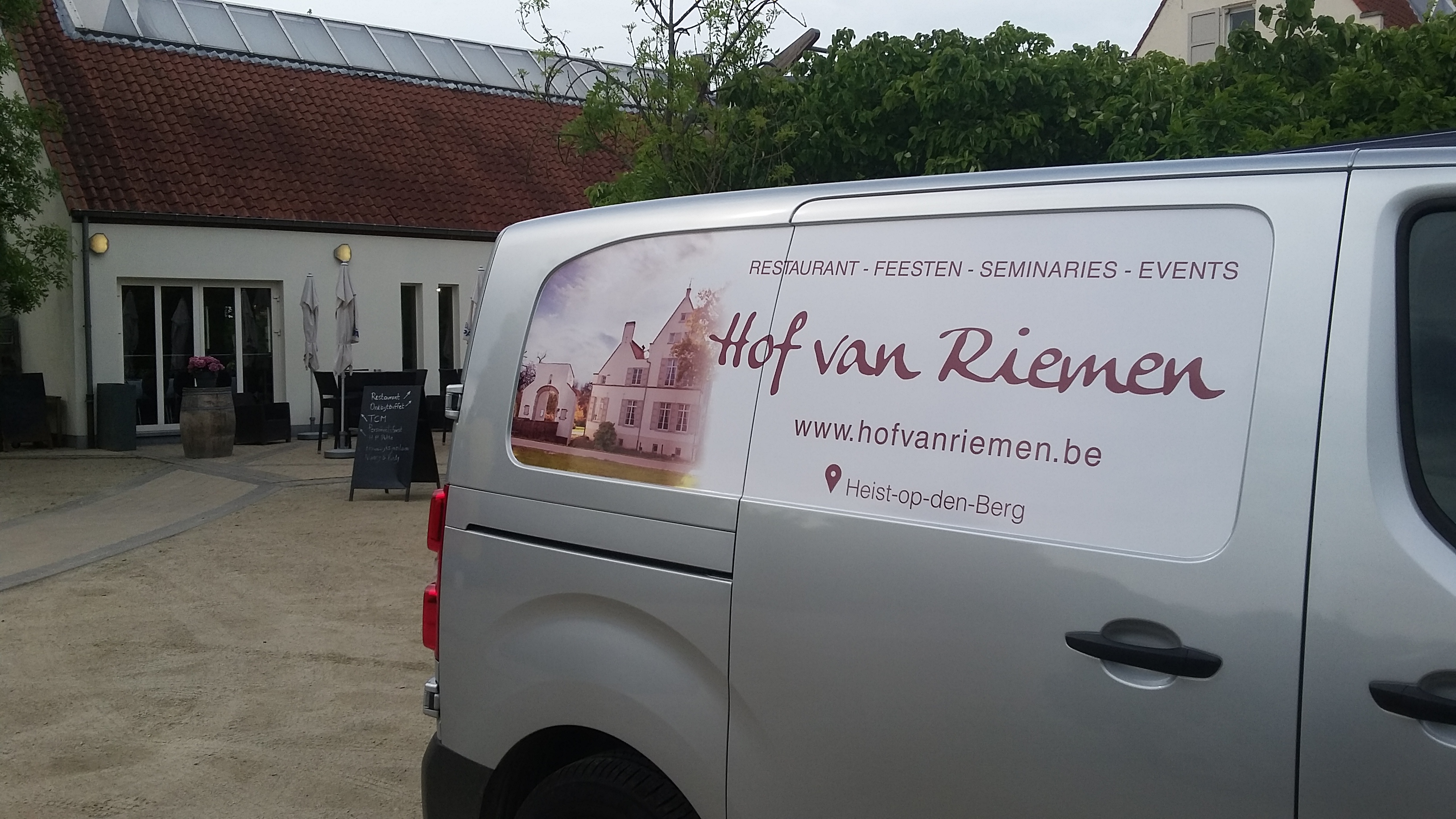

Hi everyone,
A new year and looking for a new improvement.
I normally use the vehicle templates from mr-clipart (99€ /year..) but I noticed most of the times when scaled it doesn't match the real size. Also the planes (I uploaded a photo if the term planes is wrong..) of van's are not exact to print/cut digital print what leaves me with a lot of work.
What's the best affordable resource for european van's/cars (Peugeot Boxer, Mercedes Sprinter, Opel Movano, ..)?

None of the templates are perfect. They are all slightly off in different areas and you have to learn to design around the discrepancies. Always take real world measurements of areas that are critical to your design.

If you are trying to install a graphic perfectly in the recess of vans like that, I would use a template and print an oversized image. Then install knifeless tape where you want to end the graphic. Install the print and then trim with knifeless.

For something like you posted a photo of we would oversize the print and trim to size with knifeless tape like Jester said
