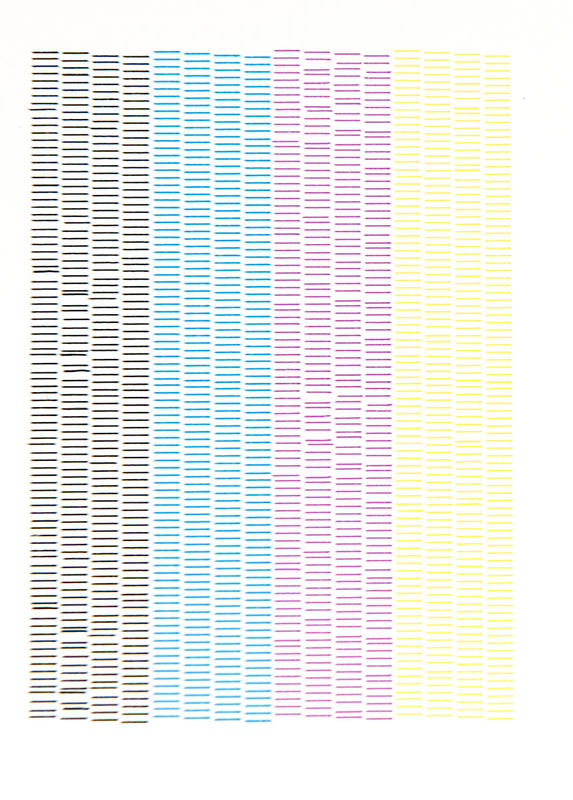

Anyone know the best way to revise deflected nozzles, I have tried soaking the heads but no real improvement.
Roland SP-540v
Any other tips or tricks?
Thanks

Cranniga1
Mixing a small amount of acetone with your soaking liquid can help, then do a 20-30 minute soak>hard clean>test print

I'm not sure about Roland heads, but I have had some luck pulling my heads and using a large syringe to slowly and steadily push solvent
through the heads. I will then put the heads in solvent and slowly and steadily pull solvent
through the heads.
I have also heard some people use ultrasonic jewelry cleaners with cleaning solution. [h=1][/h]
lgroth
I have two of these http://www.digiprint-supplies.com/dx4-printhead-cleaning-tool.html I have brought some heads back from the dead! Load em' up with cleaning solution (I use Solaris flush fluid for bulk systems, get it by the liter), I run some through the heads first, then block the lines, fill the head caps and cap em' overnight so they're soaking inside and out. Next morning I push the remaining flush in the syringes through into a cup and run a couple heavy cleans to fill the head back up with ink... Works wonders, but like everyone else says, push the flush through slow and easy.
player
I know new caps help with plugged nozzles, but didn't know that would help deflected nozzles...
A deflected nozzle is a partially plugged nozzle, unless the nozzle itself has become deformed from a head strike or aggressive cleaning, or a chunk of dried ink being scraped across by the wipers.
