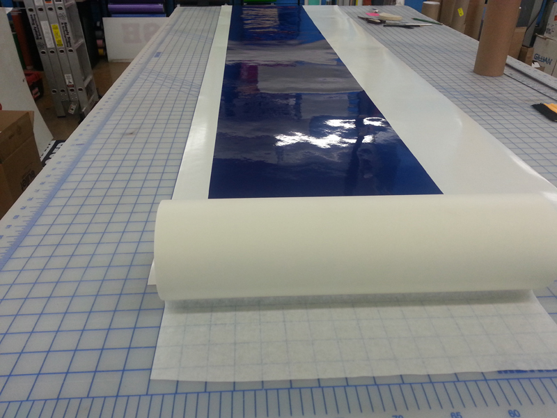

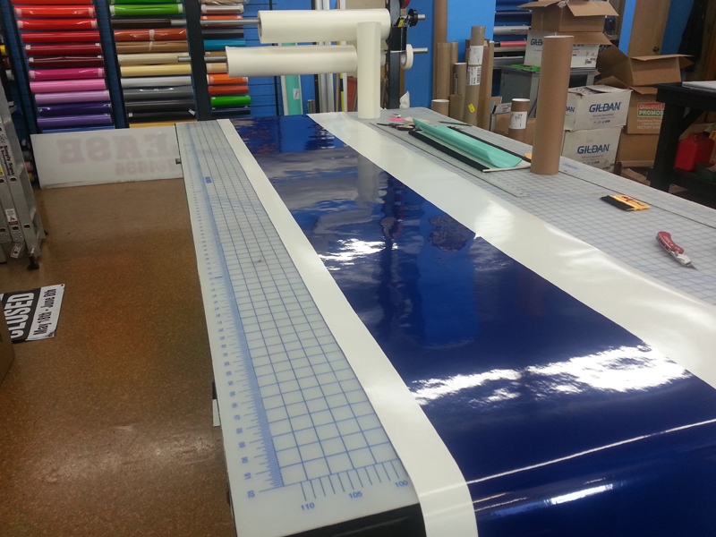

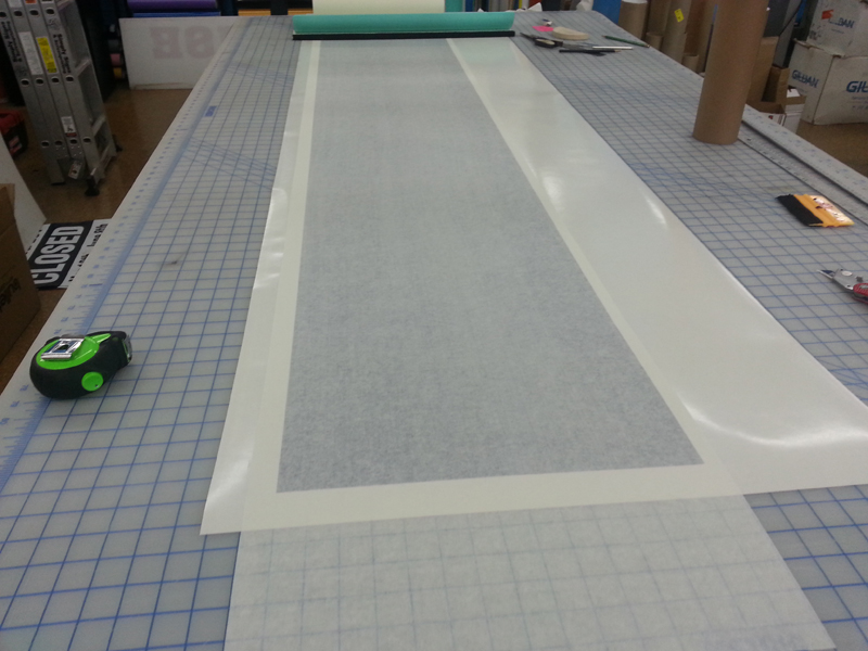

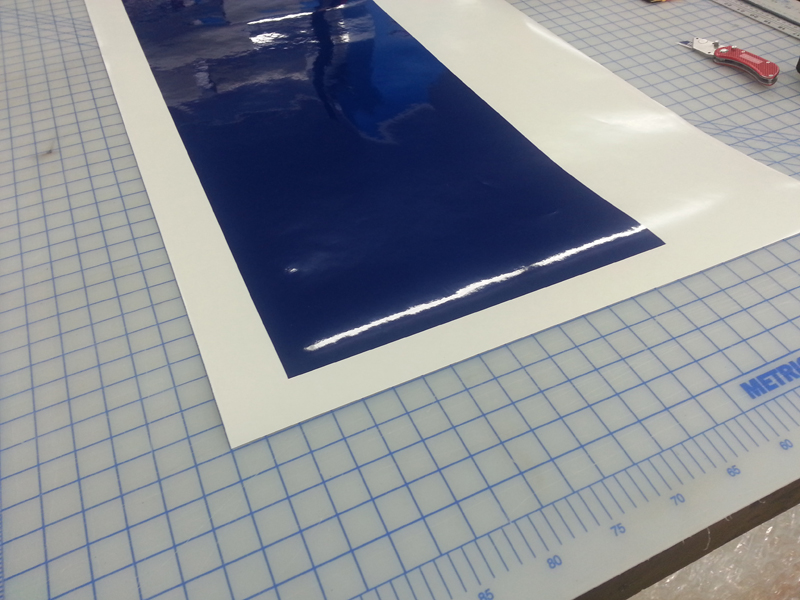

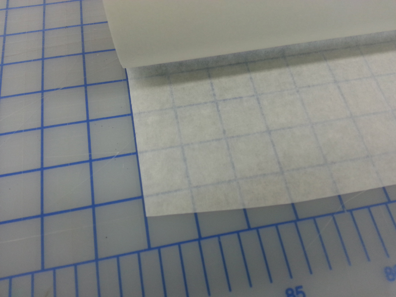

This morning I had to tape some stripes that are 177" (14.75 feet) long with the big squeegee and I figured I would take a few pics and show you guys how I do it and line everything up nice and straight. The stripes are just over 14.5" in width and I'm using a 16" roll of RTape Conform 4075-RLA to tape them off, which leaves little room for error, but it's actually quite easy if you have a cutting mat or table with a grid on it. In the first pic you will see the weeded stripe. I'm using Oracal 751 #537 deep blue. In the second pic, you will notice that I line the backing paper up with the grid down one side and then I use a straight edge and razor to cut the end at a perfect 90 degrees. Next I pull back a few inches of the transfer tape and line it up with the grid also as shown in the third pic. Next I pull the vinyl up underneath the roll of tape while being sure to keep it aligned with the grid. Next I just push the tape along with the squeegee until I work it all the way to the end and then trim the excess backing paper and tape away. In this particular case I think my tape ran out of alignment maybe a 1/4" over the entire length. Before learning this alignment technique through trial and error, I would have opted to use a 24" wide roll of tape, which would result in a lot of excess waste and less profit.
