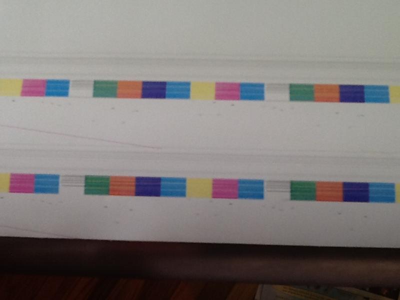

Hi all , having problems with my black head, have a falcon outdoor jr. That I just replaced the black head,damper, pump and capping station. And though I had success. And printed out a couple of jobs and looked ok but needed some minor adjustments.
That was five month ago and haven't use it since,other then doing a cleaning cycle every three days.
Well went to print something the other day and looks like just a few nozzles are working in the black head!!!
Power cleaned and soaked it but still the same.
Any help will be greatly appreciated.
jiro
CRD
Keep cleaning with soak method to see if there are more nozzles coming unclogged.
You can also pull with cleaner fluid and syringe with care on the black head peform low pressure pull through from cappingstation.
Always perform test print after cleaning............
