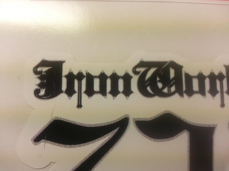

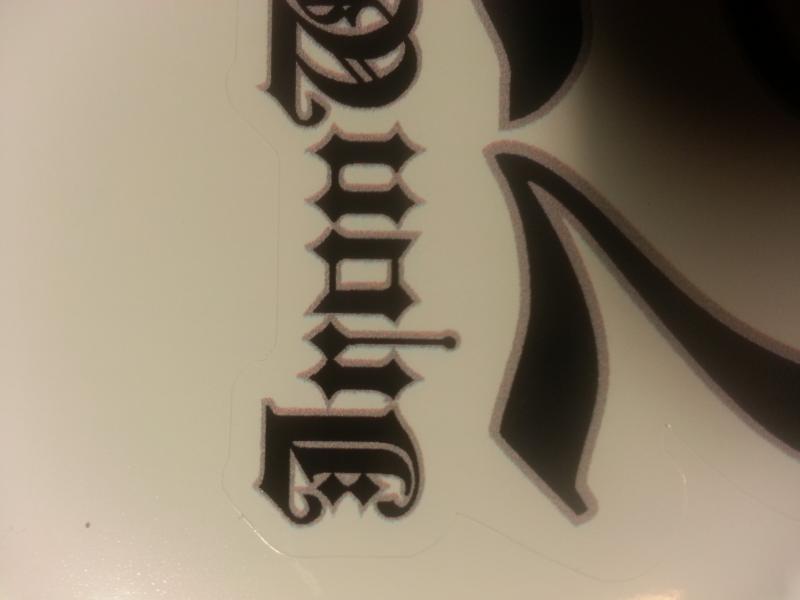

This seems to only work for the black ink.
Whenever i print it seems to double itself or print two lines.
Not sure what the remedy would be,
The test print comes out fine and tried a head clean.
The line running down from the "r" is only supposed to be a single line. As shown in the 1st pic ( illustrator file ).
The 2nd pic shows it has two ( the printed version ).
Any help is appreciated.

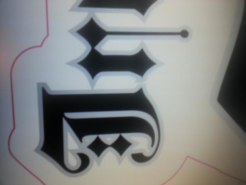

I switched the setting to uni directional and it has corrected the black stroke. As you see.
The grey out line seems to be very slightly off. It'll work for now.
I'll do a search on bi-directional adjustment.
Thank you =)
