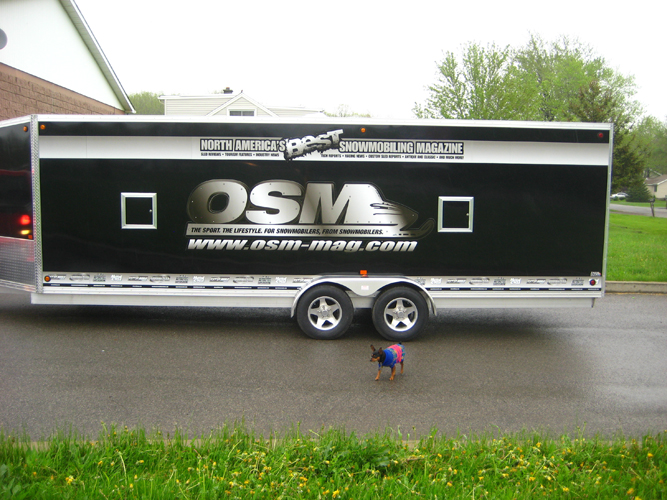

Good luck, I have another one of these trailers coming this week.... all grey gradients.
