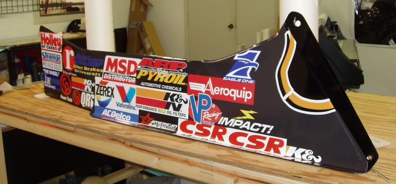

How dod i get the blackest black? We scans in a couple things and then put a black background behind tham and the scanned pieces are really black and our isn't..
