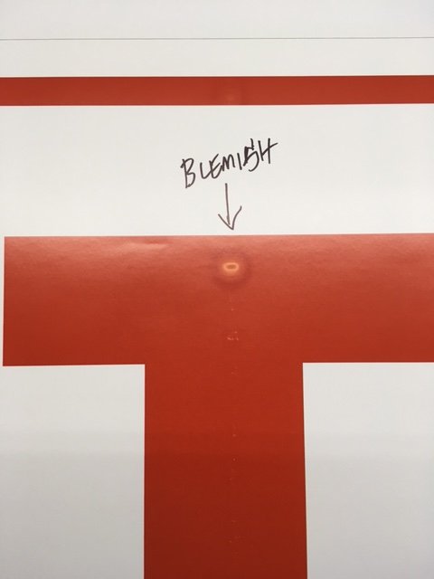

I have a Roland SC540 and am having "Blemishes" or bad spots in my prints.
Just had the Encoder strip and the Encoder reader changed out by a technician and the printer ran fine
for about 2 weeks. Also the technician changed out the dampers and a print head and "tuned up" the printer
replacing whatever it needed.

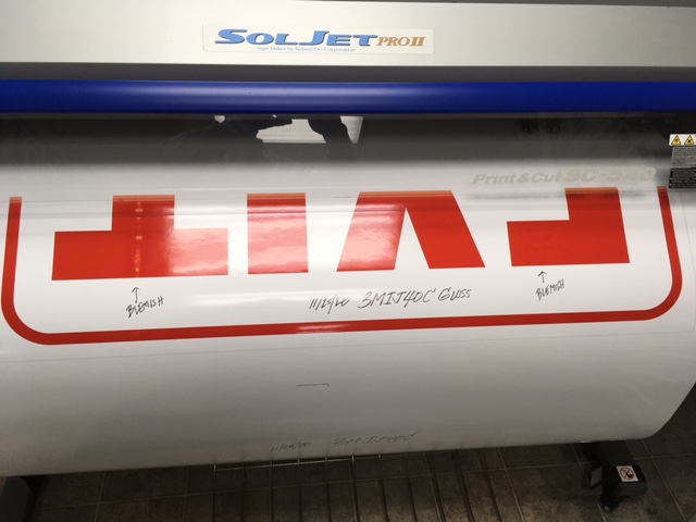

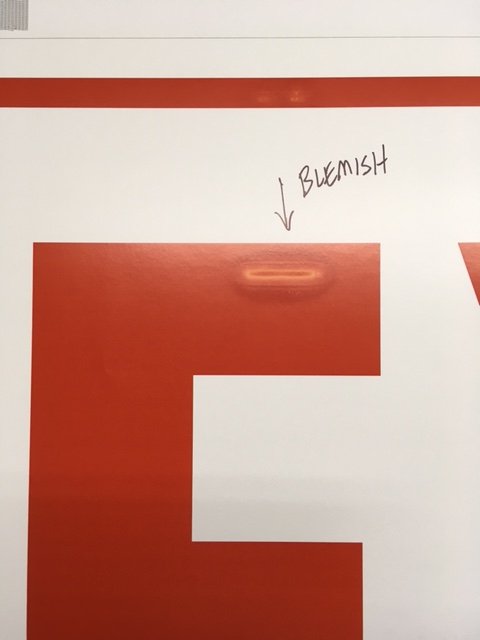

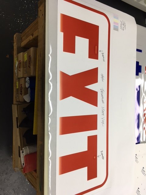

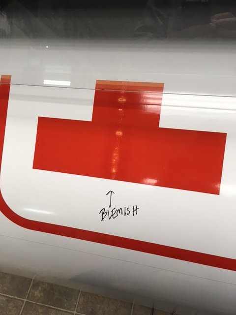

These blemishes are in a straight line in 2 places on each print no matter what brand of vinyl
I put in the printer. The blemishes are in the exact same place no matter what brand of vinyl I print on.
So it's not media contamination.

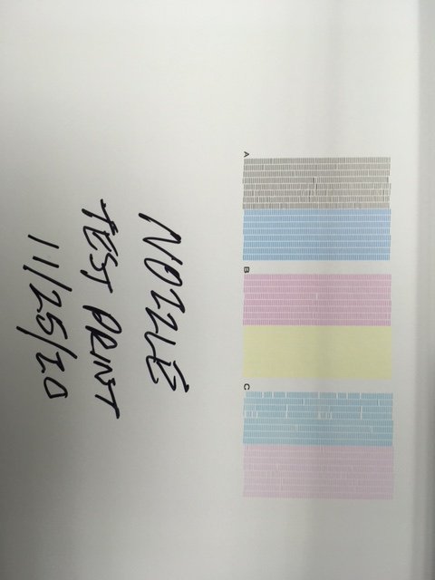

My nozzle test print is good.
Attached are photos.....
Any help would be appreciated.

Looks like the media might be getting contaminated by a pinch roller maybe? Maybe the tech greased the rail and some of it got on the roller.

That's a weird one. It looks like grease because of the way it repels the ink. It doesn't seem electrical or head related either. You have a few missing nozzles but that wouldn't cause this to happen. It doesn't look like a standard encoder issue but since it was changed recently, I would take a look at it especially in the areas where the issue is. If you see ink splatter or even grease on the encoder, it can cause weird issues and usually they will show up in the exact same place in that case just like yours. It's worth a shot to take a look and clean it if it needs it. Maybe Joe House or Jim Hancock haven't left for vacation yet and can chime in.

I take it, those are two different samples, cause the one 'T' has more blemishes than the other. Also, the word is written differently. What happens, if you change the direction of the file or use an entirely different file of some other colors and whatnot ?? This won't really solve anything, but it may bring to light some other suggestions.

It prints those blemishes in any file I print. I first noticed it starting doing it when I was printing a completely different file yesterday. The bad spots were in the exact same spot on the other print as well

There are no pinch rollers in the 2 areas where the blemishes are. Nothing touching the media in the 2 areas. Checked for oil on the rail from the technician visit and see none.
Plus if it was dripping or contamination from oil it would have to be getting on the media pretty often as it feeds thru to repeat the pattern.

I have tried 4 different 3M vinyls (Wrap, Reflective & Intermediate) we print on everyday and each one has had about half the roll used without any blemishes. It puts the blemishes in exactly the same place on all 4 rolls.
This problem just started a few days ago.

Does your media rest on 2 rolling bars in the back like a plotter, or do you have some type of media handler? To me, it looks like media contamination. Because you say it has happened with different types of media, I would start looking at your process and machine and see where contamination could be transferred onto the media.
Also watch the printing process and make sure those areas aren't buckling because of the heat settings and making light contact with the head. It doesn't look like a head strike but I wouldn't rule anything out. Also, make sure nothing else is dropping down and making contact in those areas.
