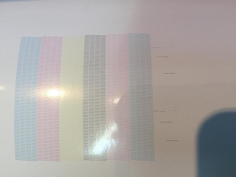

landdesigns
Did test print, the lines showing are the metallic cartridge which has a cleaning cartriage in it..?
My Roland VS-540 printing blue lines on prints...and suggestion on what would be causing it? cleaned several times, still doing it?
Ragnabrok
cross contamination, usually from the cap. not necessarily broken, could just be misaligned or the drain lines contricted/blocked.
flood the cap a few times with cleaning solution, run a medium clean and see if it improves. If it looks the same, it's probably not sealing.
