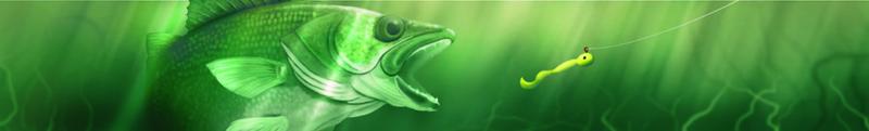

This is what we are putting on the boat, both sides, 225" long. Printed one side this morning, just about to print side 2. Using Avery 1005
Mark
We wrap a lot of boats, and having used all the vinyl from major brands, I would not suggest the 1005 ez rs on a boat. If I am not mistaken, they don't suggest using it either, but the 1005 ez. It's a little harder to put on, but sticks well. The problem we had in the past with the ex rs is that it never really adhered well to the gel coat. We use ij180cv3 on boats with no problems. Definetly edge seal though

We ARE using the 1005 SC Easy RS. Talked to a few people and they have had good luck with it. As you say, edge sealing is important and we will definitely do that. Will strips of laminate work, or does anybody suggest something else? We have used laminate strips on wraps before, but never done a boat.

The other thing to consider is the curve of the boat.
What looks like a straight edge really isn't.
Your print might look curved, etc. if you make it straight, you may need to build an arch into it.
