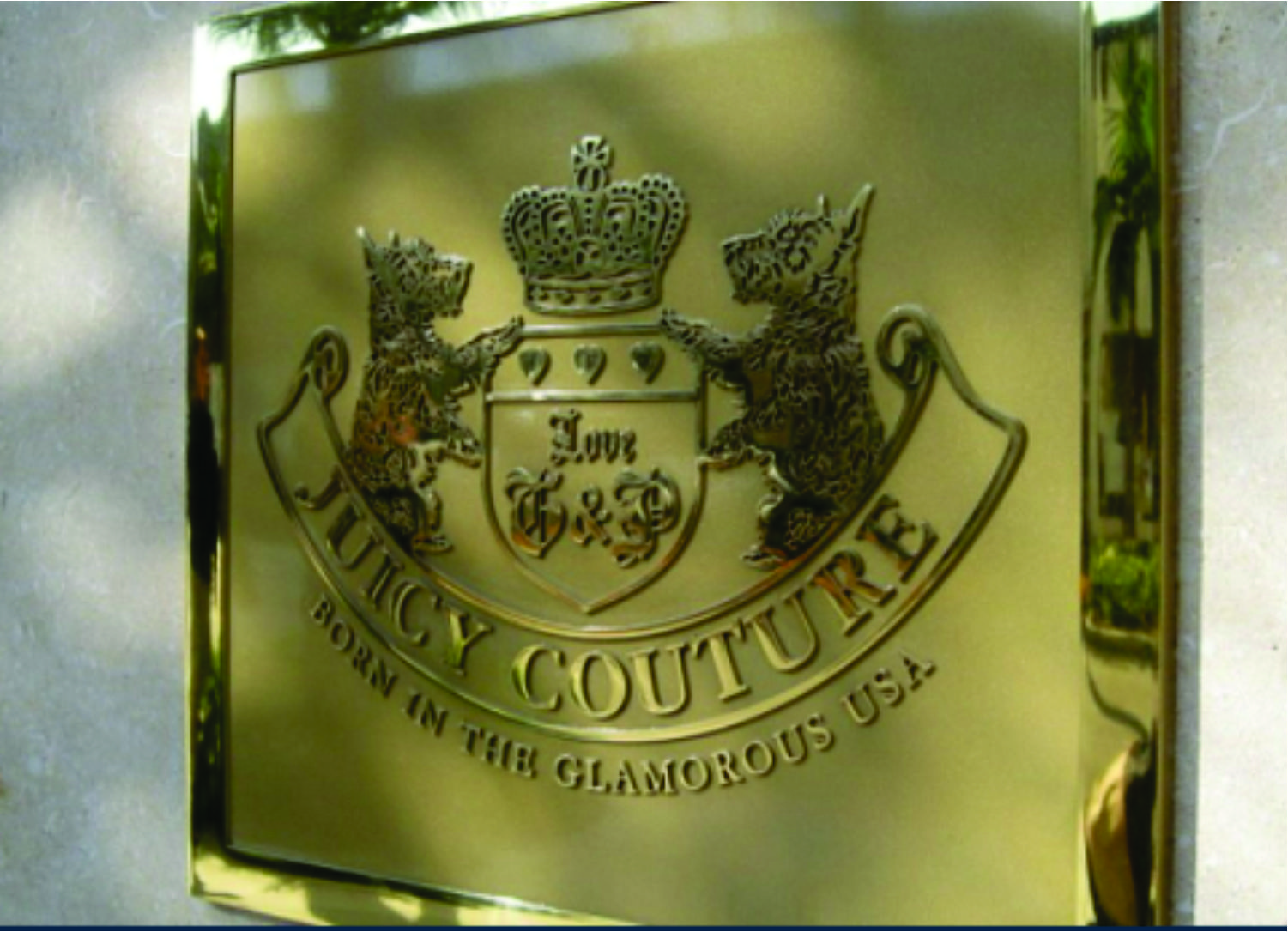

Client is looking for a brass plaque with raised brass letters/logo with brass background. Gemini doesn't make this. Looking for a source to produce this 12" x 20" similar to the one in the photo.

Hi Jean!
I get it that you're looking for a true 1-piece plaque...but as an alternative, could you order flat cut metal letters from Gemini (polished brass) and attach them to a backer panel (maybe flat cut brushed brass) for a similar look?
unclebun
From Gemini as a one piece, that would be a cast plaque. But the background of the sign in your photo doesn't look like a cast plaque. it looks like polished brass letters and logo mounted on a painted background, installed in a polished brass frame.

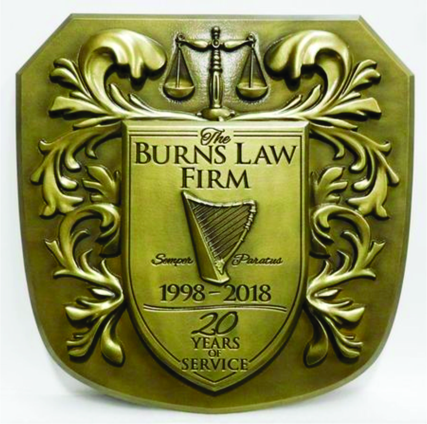

Jean Shimp
How about this? Any idea where to get something like this made? Just thought I would ask.

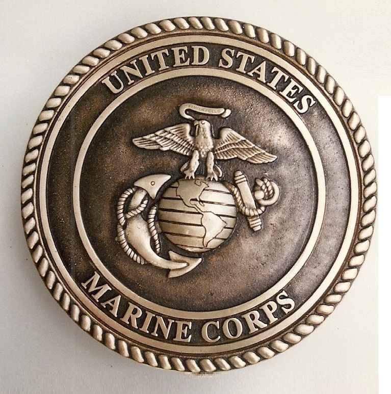

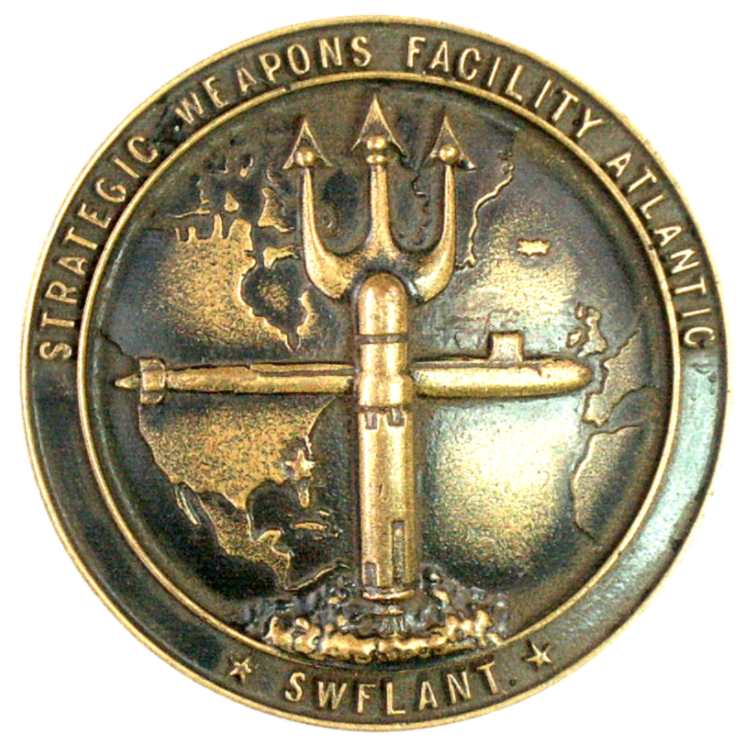

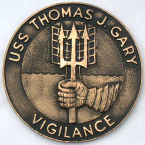

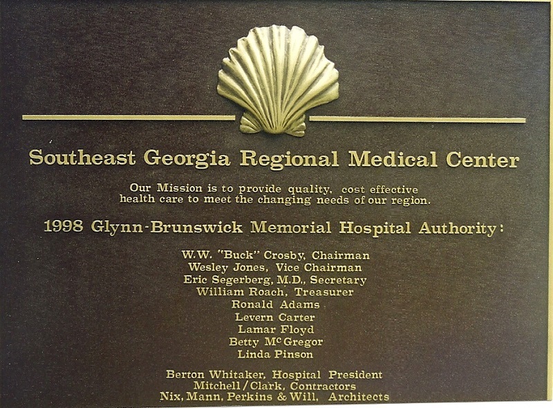

why does it have to be real brass ?
why can't you carve it out of 30# HDU or other high density material and paint it ??
here are some I made a few years ago - they are cast acrylic and "hand painted" with brass accents.
