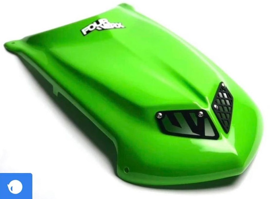

I'm having a tough time finding a color code for a bright green that will go with the attached pic.

You simply can't print fluorescent colors on a CMYK printer. It's always going to look washed out compared to the real thing. Print the picture above with your printer and that will give you an idea of how close you can get.

It needs to be printed on high tack vinyl and laminated. I just haven't had any luck finding a color code that's close to the plastic hood.

Well, here's a color match trick I used to do many many years ago. Go to your local auto paint supplier and have them color match a spray bomb. Vinyl used to take paint really well. But YMMV. Before digital printers I used to do base/clear on vinyl for all kinds of special effects. Also airbrushed acrylic enamel on vinyl.

The best color I've used in the past is PMS 375 or 376, depending on the profile you have.
