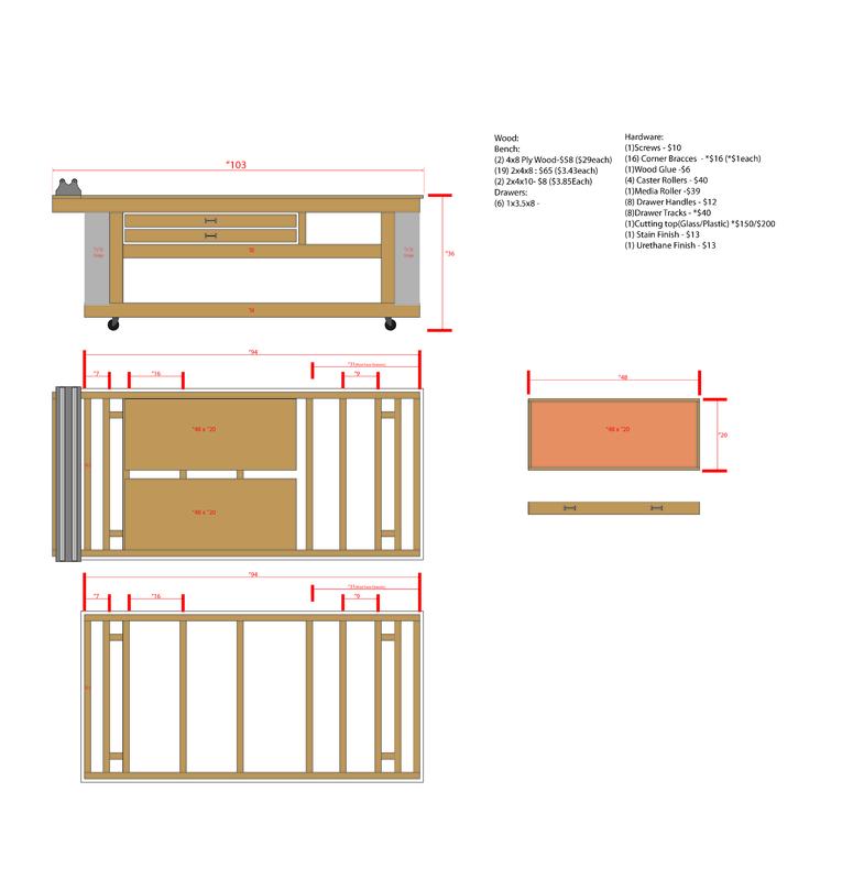

Hey Folks! I'm building my second work table. I'm Making this one a little larger than my first one. It's going to be 4x8 with a tempered glass top drawers etc. I'm wanting to put a grid under my glass top. I was wanting to print my own so I could customize it a little. Does anyone have a vector file of a Grid system for a Work Table they wouldn't mind sharing. Thanks in advance!
Below is a quick sketch of the table.
