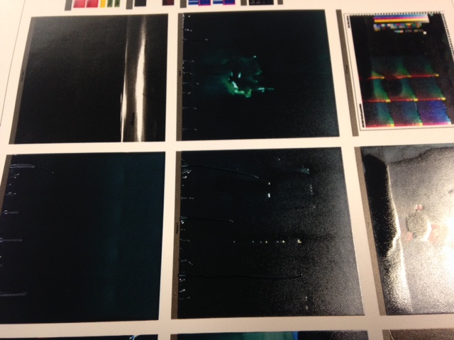

Hello,
I just installed caldera and its laying down massive wet ink for the generic vinyl profile listed, so tests are a little depressing to start off. I cant imagine what media could soak up all that ink.
Has anyone had problems with this much ink?

been using caldera for 1.5 years now and do believe it puts down a lot of ink, but not usually that much. Have you tried more than one of the canned profiles?
There are a ton of settings in the rip, many of which can cause one issue or another. Make a profile and see how it does.

I really like the clean look of versaworks and it prints well for me. Its just missing a few functions I want. Now I want to cut with a summa so this is the route we have to go for that. If I can get good prints off of caldera I will be very happy. So far tech is telling me to change profiles because the ones it shipped with may be out of date for my printer.

So I have tried a media profile patch caldera sent me for a media I have never heard of and I got a very decent print on matte vinyl!
They said the shipped profiles were from before "rolands intelligent pass tech".
That's kind of funny because that came out like like 5 years ago, so im not sure why the included profiles would have not been updated since, but I guees they support a lot of printers and updating old profiles is up to you.
I tried 3 to start and they all were pooling ink big time, generic vinyl, premium vinyl, and matte vinyl.
