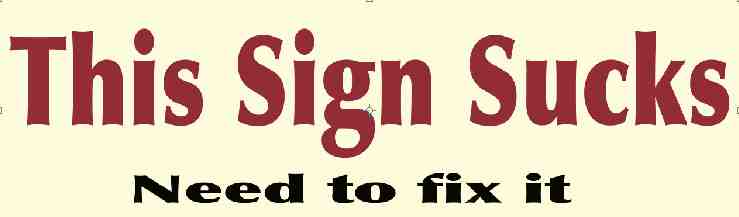

coulda woulda shoulda
My choice would have been cut, but printers like to print because it's faster than installing cut.
I let them decide how to build it, because that is what they do.
I just called them again, and am waiting for a call back.
I am curious as too how you guys would handle this.
If it was a smaller sign, I would just redo it. But it is 4' x 12'. It looks like this...
Mosh
If it is printed on Trans vinyl can you remove the print from the lexan and apply cut trans vinyl...reverse cut the beige and the apply red over it...assuming it is white lexan...
MikePro
aside from dual-layer printing, if I were to do cut vinyl then I would have used trans. red with a black outline and opaque beige.

no problem at all! flip the face in the sign cabinet, and install the reversed clear print with the sign-lit.
...we have a light table, but if I didn't then I'd be doing this all the time if I needed to.
this second-surface application is really easy. you don't have to worry about bubbles nearly as much since they really won't show-through the face that has another graphic applied.
