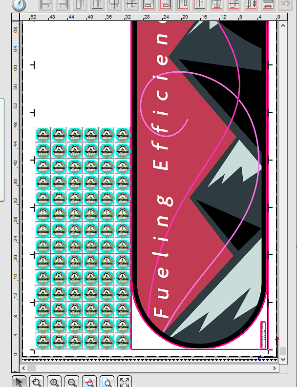

Is it possible in Flexi Complete to print & cut multiple jobs side by side at the same time without having to nest them together?
I want to print a panel that is 30" x 450" and have it have its own set of crop/cut marks. I then also want to put multiple smaller 25" x 20" jobs on the same 60" wide print and them have their own crop/cut marks so I can cut them out at a later time and not have to nest and cut everything out at the same time.

Maybe I'm looking at this wrong, but based on the photo, it looks to me like you will have to cut everything before you weed anything.

There should be an option in the cutting tab to put the marks around the entire nest or individual files. I can't remember what the setting is called off the top of my head but I am pretty sure it's there.
