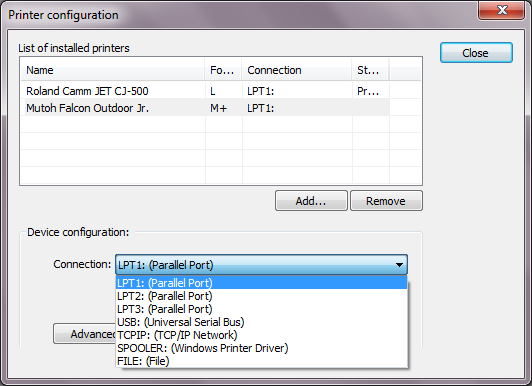

Falcon Jr, with Flexi 8.1 pro I have cyber print, but I cant get it to print out of it...right now im using ltp port, cause I cant get the fire wire thing or what ever thing came with it...that runs off of a eithernet cable...
CS-SignSupply
If you are connecting to the JR via a Parallel cable, you should have your CiberPrint set to LPT (1,2, or 3) whichever you have.
What settings are you using in Flexi?
