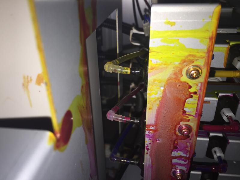

Yesterday my printer started saying subtank refill, I looked online for a solution and found a forum with this same problem happening to someone else. A tech told him to syringe the ink through, my question is how do I remove it and syringe it through?

Yeah it'll get stuck on that screen and then I get an error. If you look at the pic both the yellow and magenta have air in the lines. How can I remove the hose and syringe ink through it? Is there a video anywhere?

Update tried syringing the ink through the lines, then doing a "little charge" from the menu but it gets stuck at 98%. Then if I try to print itll say subtank refill and eventually give me an error E178Err SubtankHi M. Can anyone please help me out I'm stuck and don't know what is going on

From what I can see in the pictures you have a lot of ink in the area of the sub tank that shouldn't be there. If the sub tanks are not filling my guess would be that your sub tank valves are stuck closed. What model is the machine and what firmware does it have, also how old is it?

The machine doesn't actually know what percentage of it is full. It just guesses and when the high sensor trips, it goes to 100%. Since yours is stalling at 98% my best guess would be a clogged valve, bad high sensor, or even the cartridge being empty and not flagging the machine properly so there is no ink to fill it in the first place.

I would check their is ink flowing through the ink tank solenoids.
As the lines at the top are from the ink cartridges and the lower ones are into the subtanks (you can see the subtanks behind).
I have changed my solenoids twice in the 14.5 years I have had my VJ1604.
I managed to clean them through the last time I had an issue.
