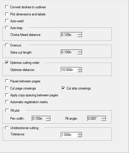

Flexi sends the cut job in the order of the layer stack by default. It does have an "Optimize Cutting Order" function as well based on a distance you set and things like "advance after plot" which one of my guys likes to turn off which irritates me.

401Graphics
You can optimize cutting order in flexi
