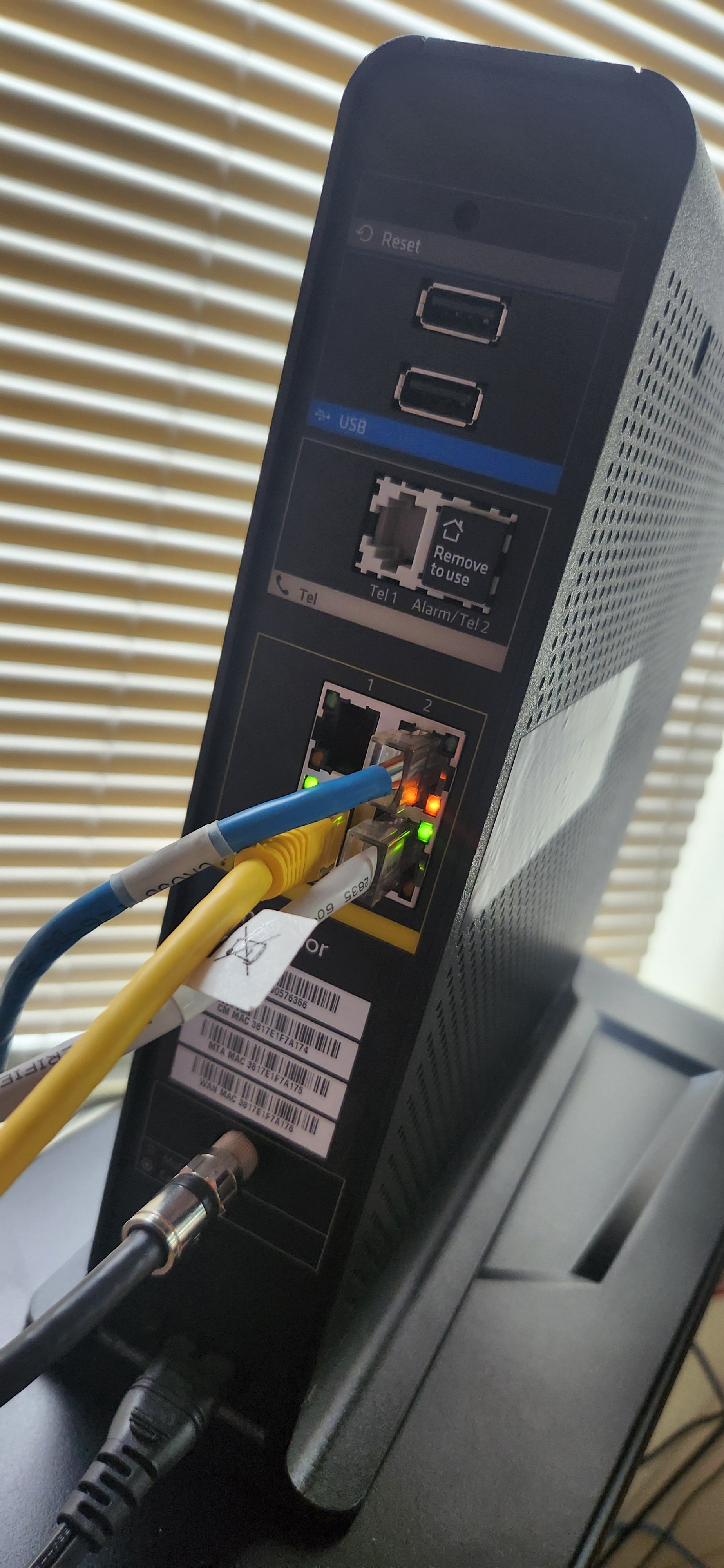

When I hook the printer up directly to the router (the blue ethernet pictured) the port lights up orange which I assume signify the connection isn't good/complete?

I switched the blue cross over cable with a 7' cat6 cable as suggested. Still no luck. I'm assuming the network chip may be cooked? The crossover cable I what I used for many years prior.

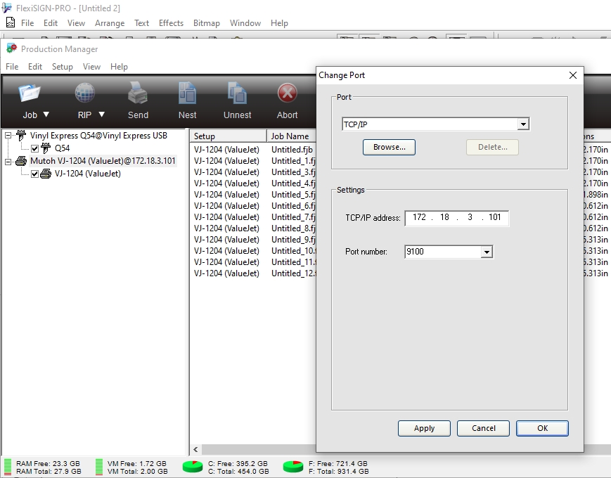

How do I know what "PORT" to use in the setup from production manager? I've included a screenshot I'm using port 9100.
My IP address between my machine and PC match and I have tried 1 digit off as well.

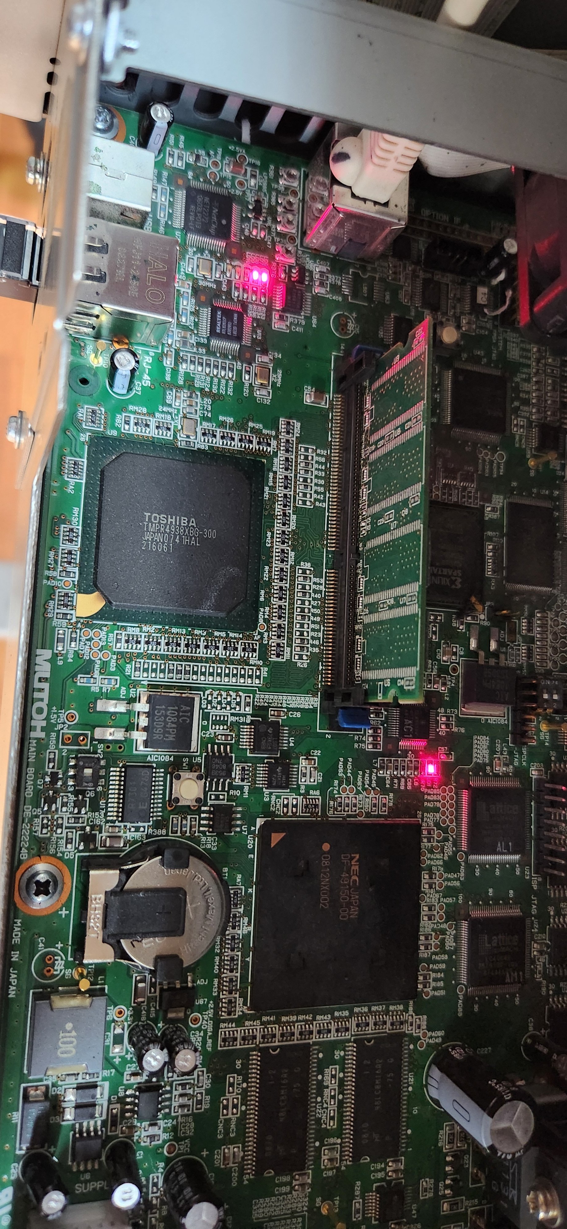

Looks like the network chip is attached to the main board :confused:. Is there anyone that can repair these. Or is a new mainboard in my future if I want to get this back up and running??
I've included a pic of the main board, there are a few lights lit.

Since you changed the network card in your PC this is likely the issue. Just change the IP address of your new card to 172.18.3.1. Then plug the printer back into the PC directly with the crossover cable. Don't change the port number in PM. (assuming your printer is still set to 172.18.3.102 as shown in your screenshot). After that, try to ping your printer's IP from the command prompt

printer ip 172.018.003.102
production manager 172.018.003.101
my network ip currently is 75.75.155.241
this I am trying to change to the same IP as Production manager? 172.018.003.101
weyandsign
Your network ip of 75.xxx is the one connected to the modem for the internet. Since you have 2 network cards make sure you're changing the correct one. Subnet should automatically fill itself in when you click on it, it's probably going to be set to 255.255.0.0. Make Your IP and gateway and DNS the same number for your network card (172.18.3.001)and leave alternate DNS blank since your doing a direct crossover connection. The IP in production manager needs to be set to your printer IP address. Can you post a screenshot of where you're changing your network card settings?
