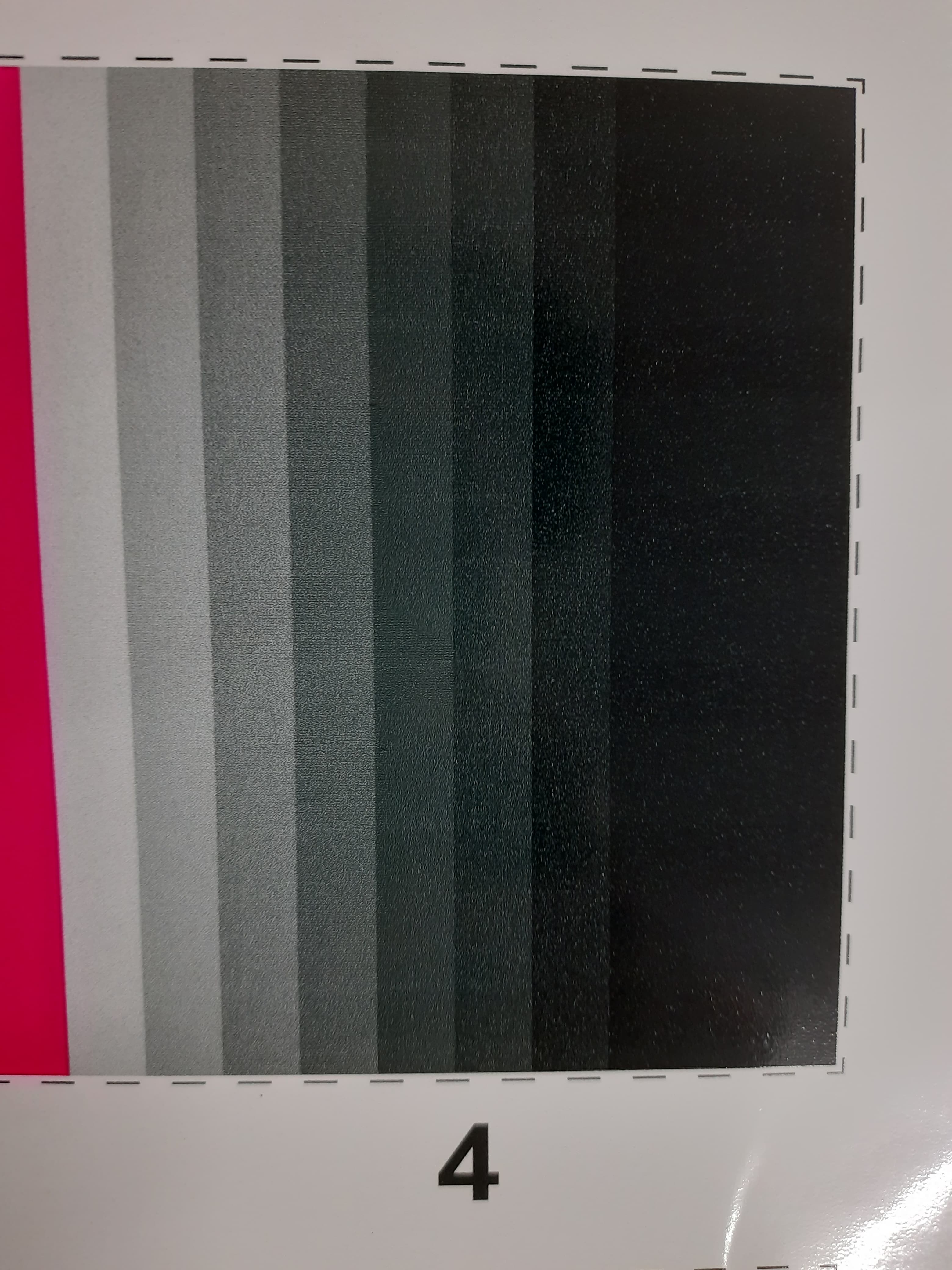

Okay the print head has been changed, the techs were not able to clear the nozzles ....but even after this we are getting banding .... even after changing the step value ..increasing the mode ( robust mode/improved print strategy) ...
all this is happening in the glossy production mode... we do not use the slower modes as it wouldn't work out financially based on the cost we charge out customers and the printer can print at 1800 sqft/hr but we just want 30% of the max ....this is happening only on smooth media (non woven & vinyl) we have tried different banded media but still the same ( 3M, Avery ...)
the banding is white line from one side and then it turns to a black line ...
note majority of our work happens on textured media (ie textured Non woven, fabric back wallcovering {similar media that dreamscape uses} 20 oz. TYPE II) and on those media we do not see banding as the texture is that much ( that is what we assume )
Noob Printer
we have done all the maintenance, auto, manual, periodic... check the buffer plate... checked the roller in the tray if it is getting skewed, checked the rewinder...pinch roller have been checked... all okay...
also to not when we print on smooth media the rewinder doesnt roll the media straight,, but when we print on textured media it rolls it perfectly
