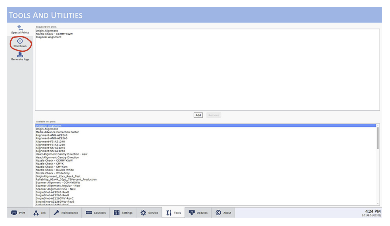

-I can't do anything on the PC, it has no keyboard, just a mouse. The print driver interface is frustratingly simple with no shut down or restart option and I can't even minimize it to get to the desktop. If there is a power button on the back of the workstation somewhere I haven't found it.

Go to "tools and utilities" there should be a shutdown option. that does the proper shutdown sequence. unless your interface is completely different.

Thanks. Restarting now. I think I found the problem. The top take up shaft wasn't tightened all the way. It couldn't rotate the tube and put tension on the media.
