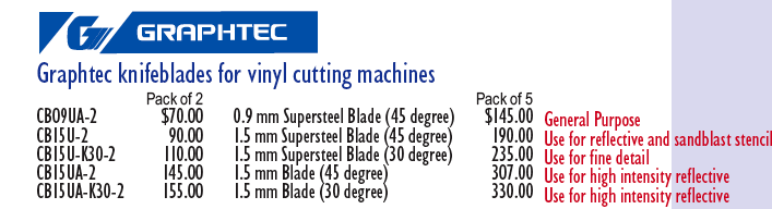

CB15U-K30 blade
sinetist
Looks like it's meant for cutting heavy reflective stuff.
signage
The Blue top is the CB09 normal use and the Red top is the CB15 for either fine detail or heavy material. Both holders accept different degree blades!
jiarby
yes, the both hold different angled blades, but the red is for CB15 blades, and blue for CB09. If the OP wants to use the CB15-K30 blade he needs the RED holder
