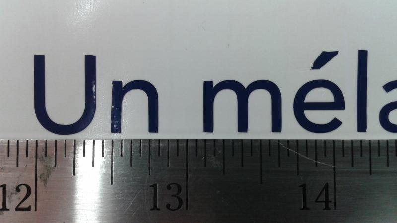

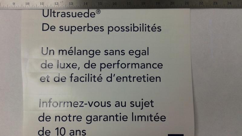

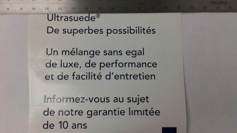

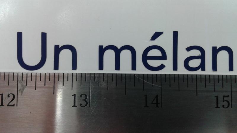

Lea Marc
Here are some pics, I've ran smaller text and had similar issues. You can see where it's picking at the joins of the text. This is on Oracal 751C.
