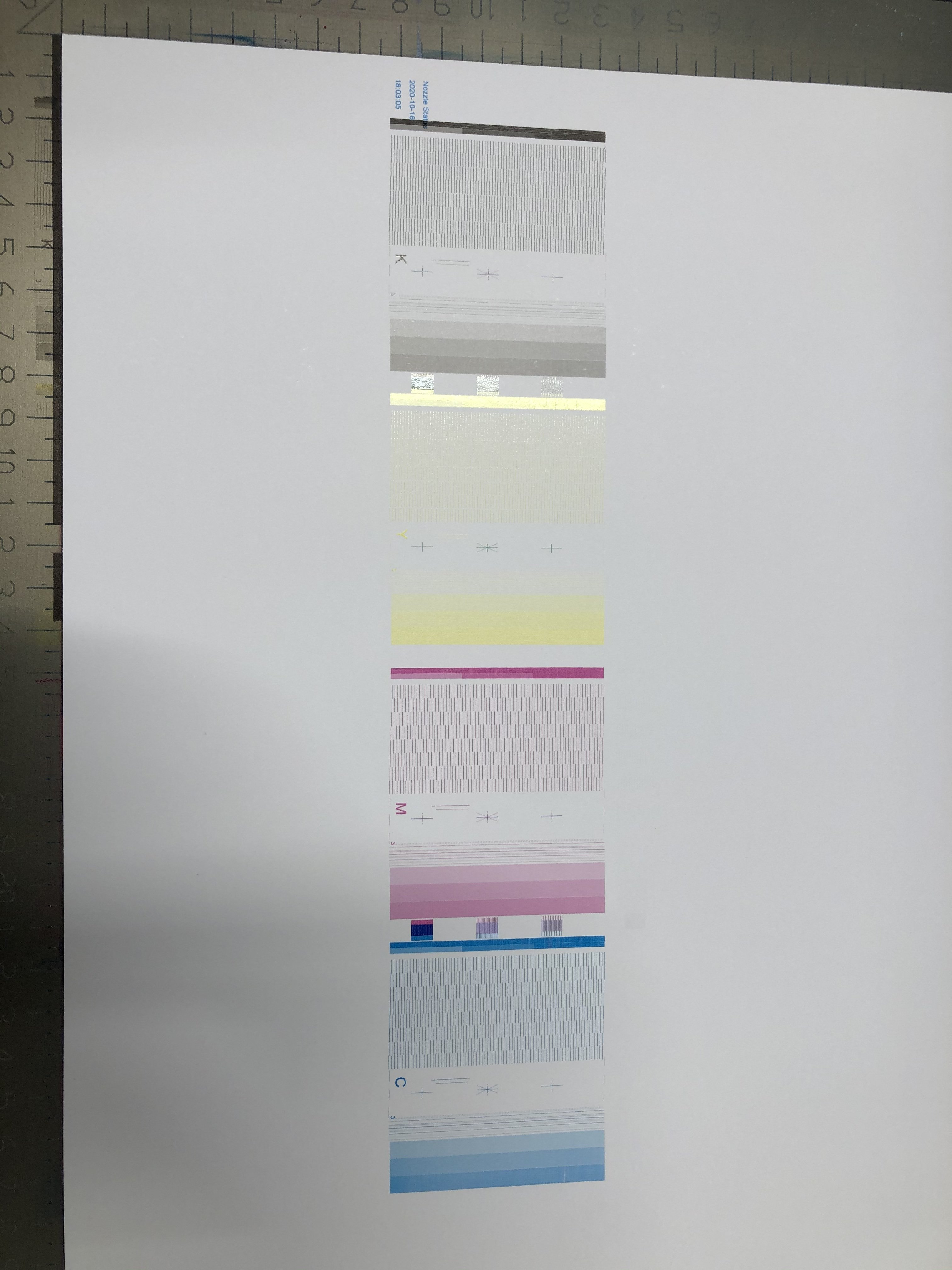

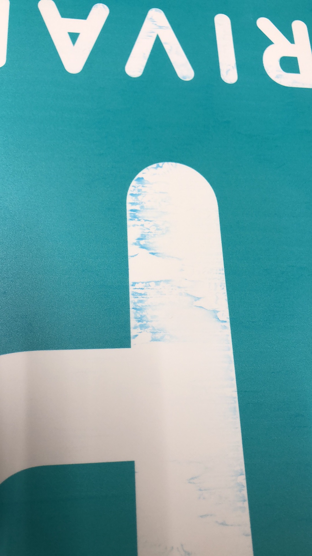

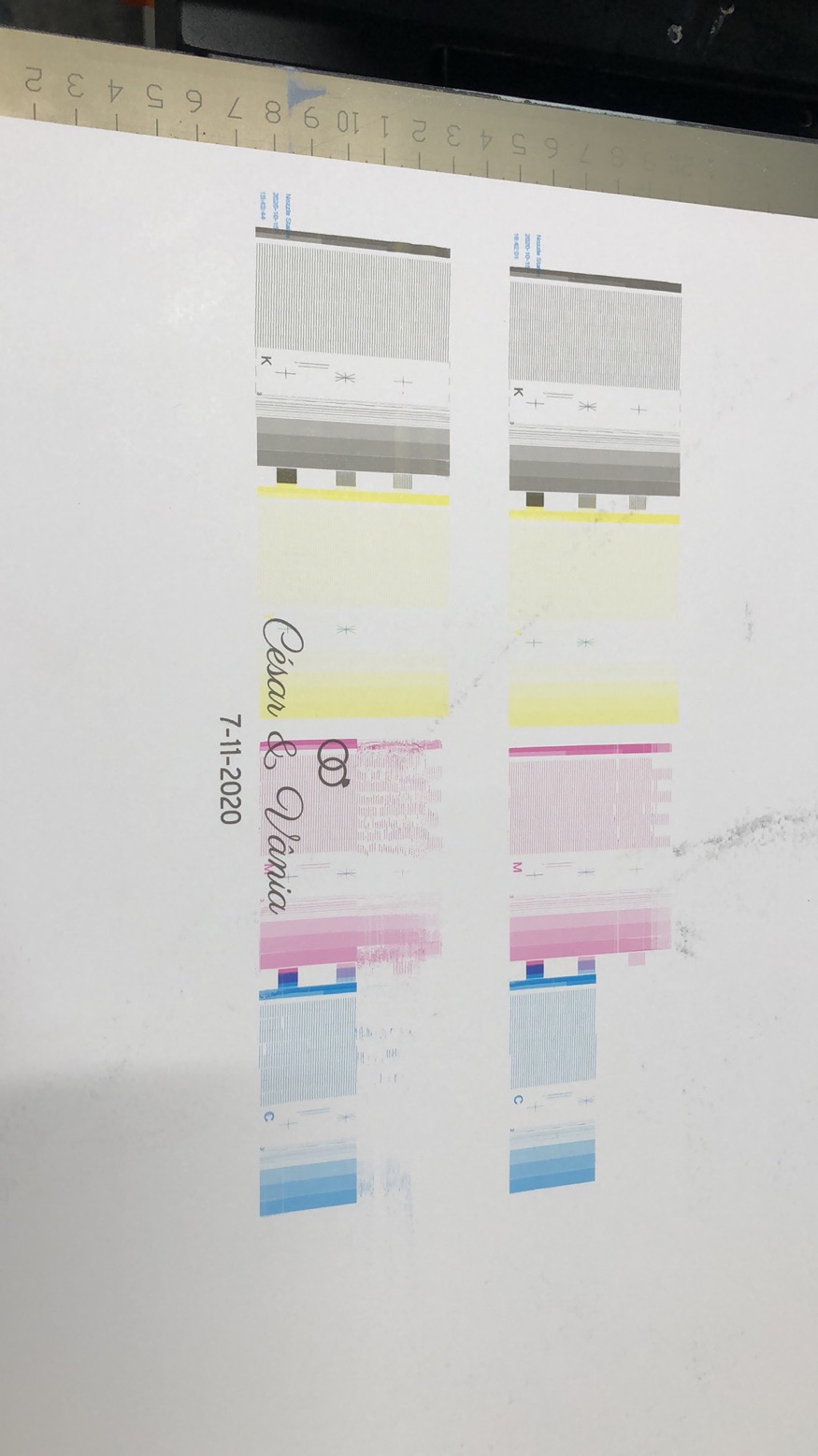

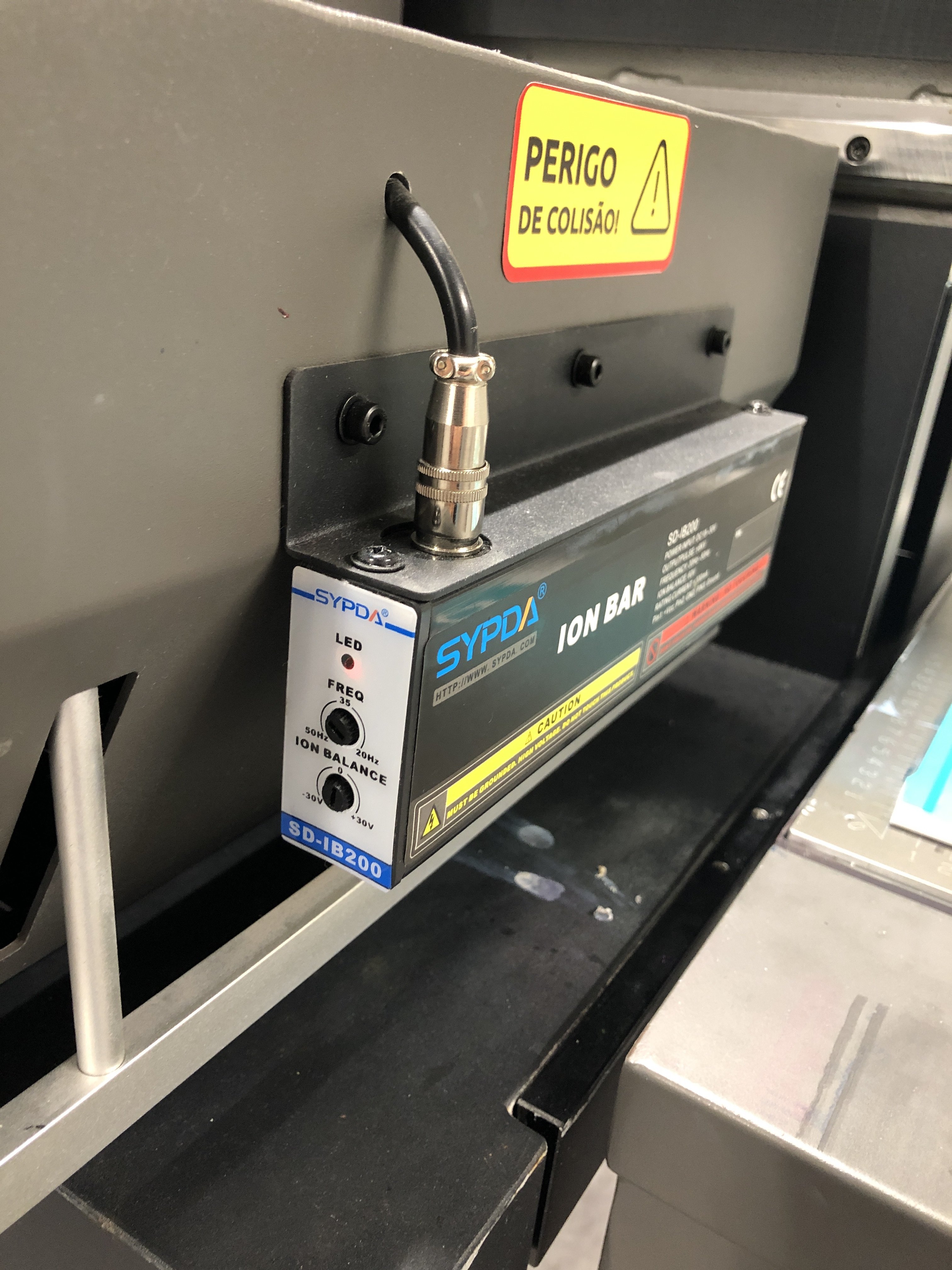

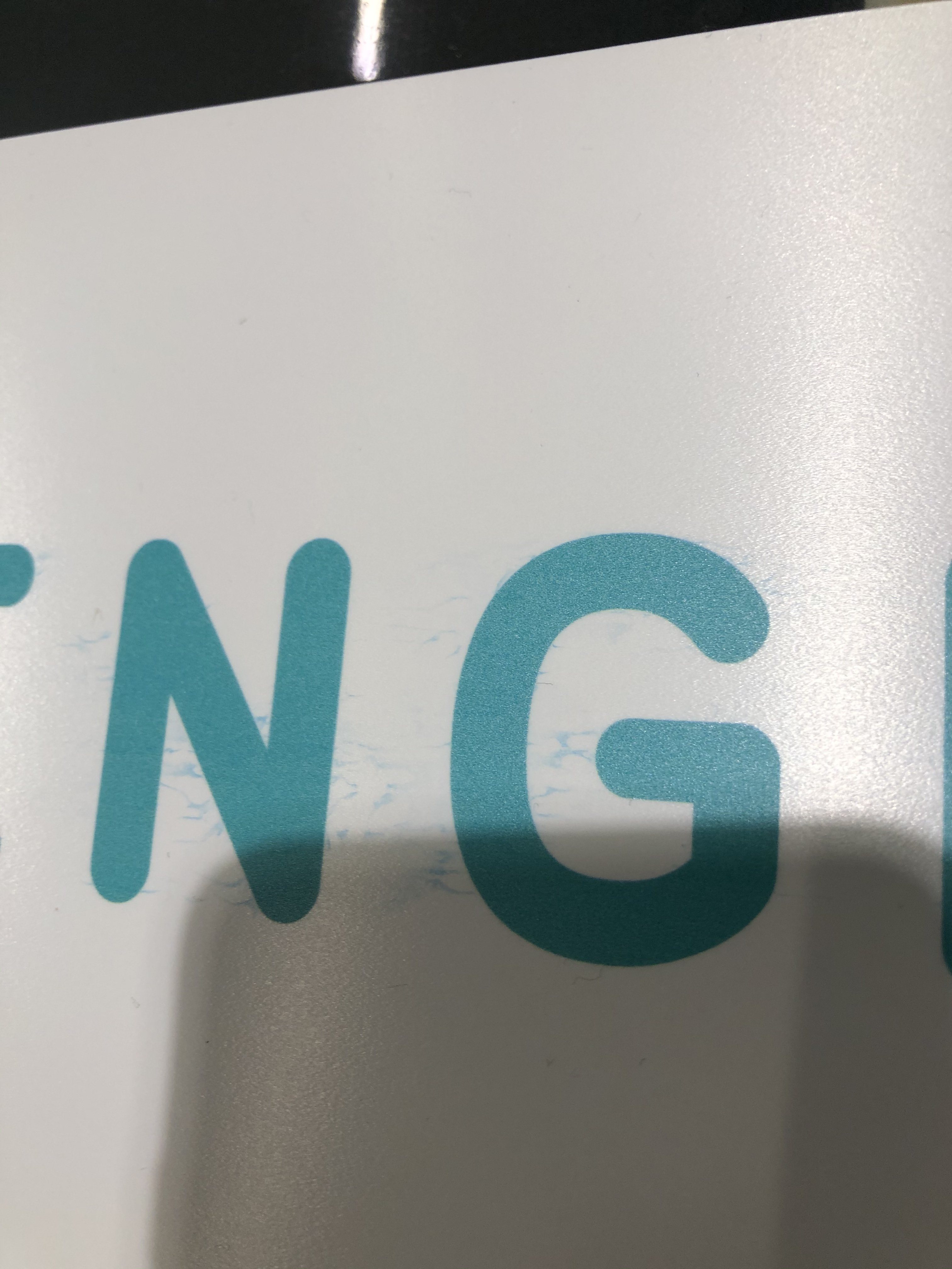

The problem is PVC foam boards, and that's what we mainly use it for! Cyan color starts to fail, or creates strange "clouds" of ink, like electrostatic... The machine does have an electrostatic "remover" (or wtv it's called) and if we turn it on, cyan ink starts to fail. Strangely, it's always Cyan, not any other color!
Photos are attached.
Few things we tried: purging head, new printhead, new control board for head, cleaning/purging cyan ink circuit, new cyan ink, and probably more that I don't remember...
