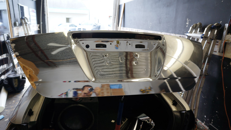

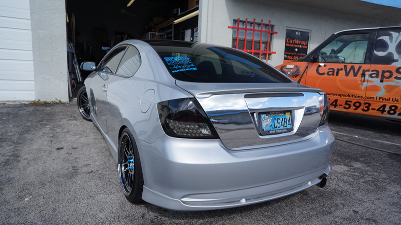

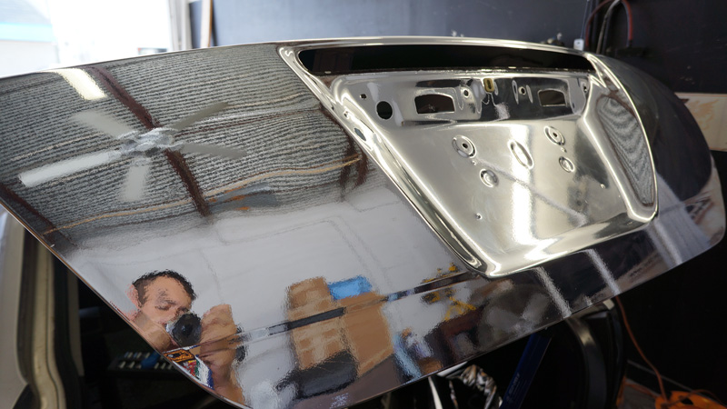

Finally had a slower day at work so I installed the Avery on the trunk. ( Yes... I didn't had any slow day for almost two months)
Loved the avery chrome compared to the hexis one.
You can slide it around, adhesive is not super aggressive.
Air release <3
Darker chrome than the hexis which is very good because the hexis was very cloudy / milky?!?!
But it also has much more orange peel look.
Managed to scratch it with a brand new squeegee and the felt had soapy water on it. :(
Not much stretch. I was surprised that I could stretch it in license plate area. It felt super rigid around there.
