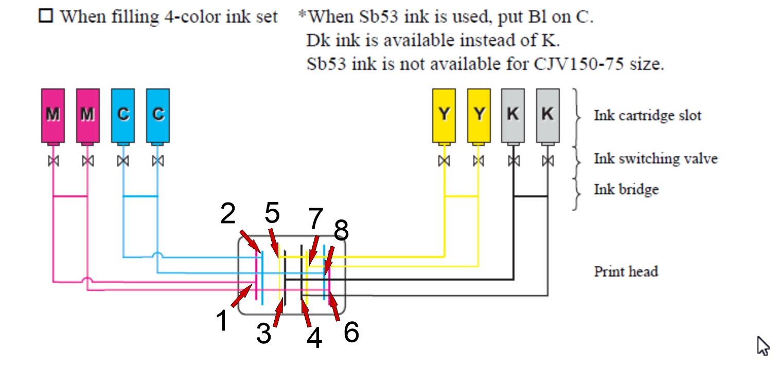

We are setting up a printer with dual CMYK inks and I found this diagram. Is this the correct setup for the ink lines from the cartridges to the dampers?
