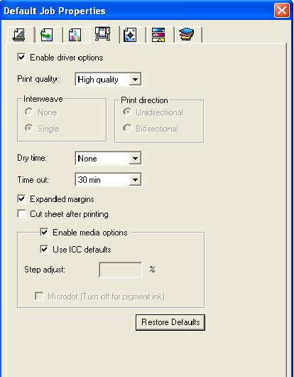

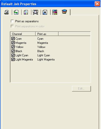

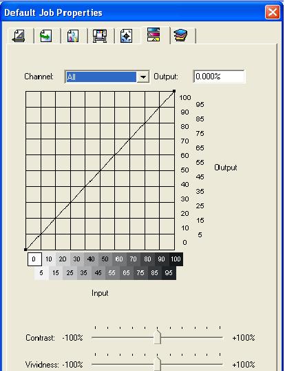

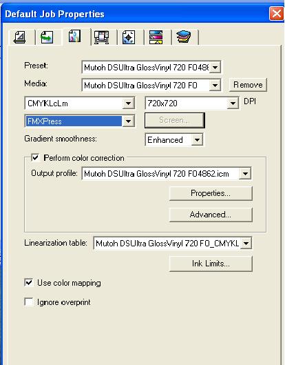

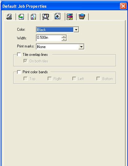

Thanks folks this all has been a learning curve and I can sell the clear to a guy down the road anyway....Also I do hear about spot printing. That is using just the colors that the image has, correct? not sure if my software is setup correctly?! lol anyway for the most part do printers just print using all the colors or is the program setup to print just black or just red if image calls for it? I have attached a few images of my program to see if I have things setup right
Thanks for all your help folks]

Your settings in flexi appear to be correct, although it will ultimately depened on the color profile/preset that you are using. FYI, most of the ones you find on the web and download don't work all that great.
Spot color printing / color matching is not much fun. All your spot colors will convert into their closest 4 color process (CMYK) equivalent. This will mean that spot reds and blues will be tough to get to output.
You need to turn off the spot color mapping unless you are specifically trying to map one of the spot colors in your drawing to a particular ink color. For example if you draw something with a spot black in your drawing, then turn on spot color mapping, and then select the black to map to the black ink... you'll get a pure black print. This can save you lots of ink when printing black text for example.

I've never see a mutoh rip that allows for multiple strike printing. Now if you set it to high quality you may get a 16 pass print... but you need to have a color profile setup for that. Its not like you can just play around with the print modes and expect consistent output.
Regardless of what people may say around here print modes are directly tied to the color profile. So if a profile says its a 720X720 CMYKLcLm High Bi Directional High Quality....then just picking 1440X1440 as your resolution will not get you correct output.
