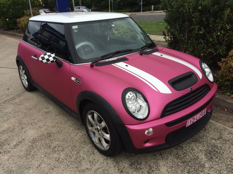

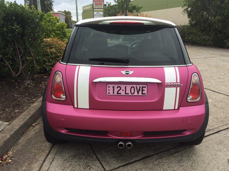

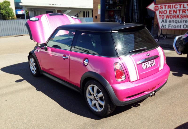

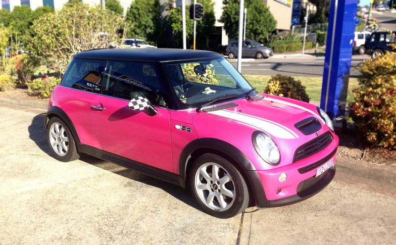

the job came up ok, here's some pics of the finished product from september 2013
It was originally the heritage green colour.

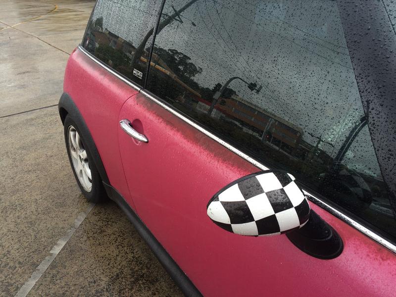

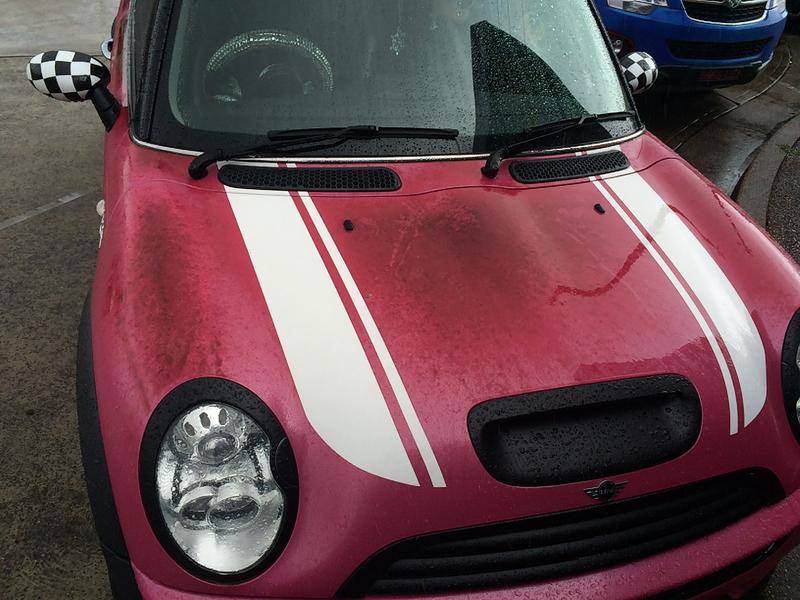

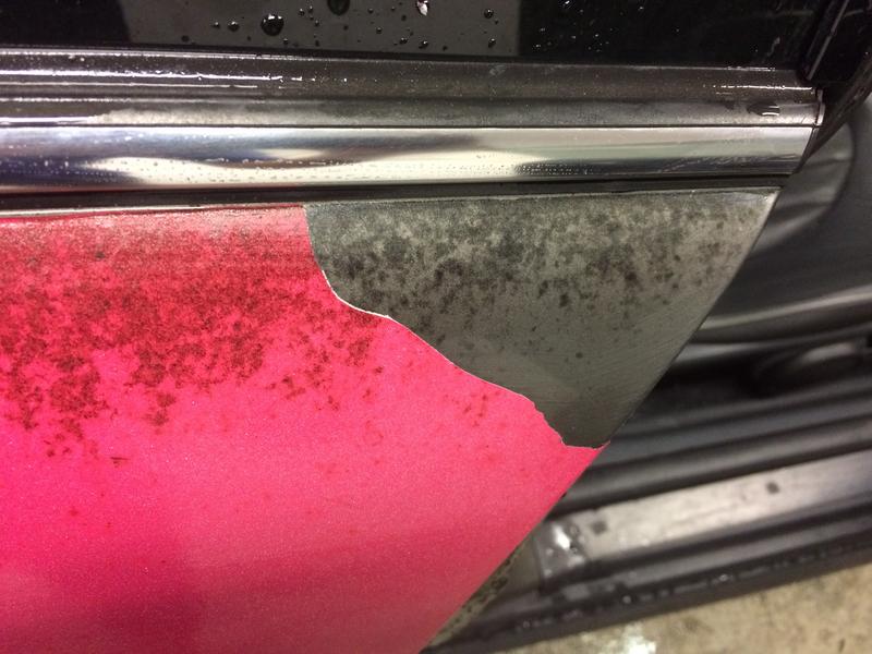

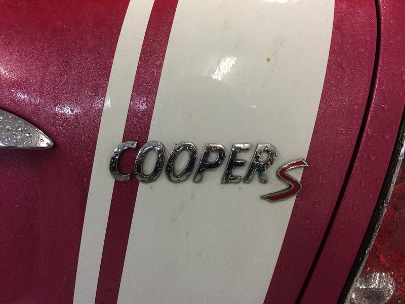

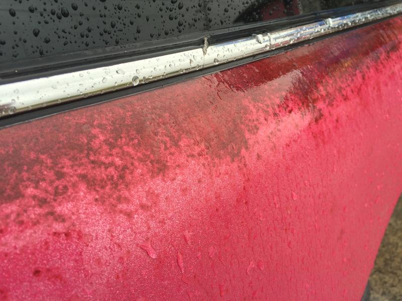

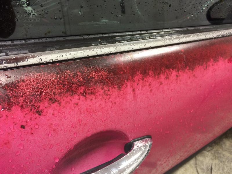

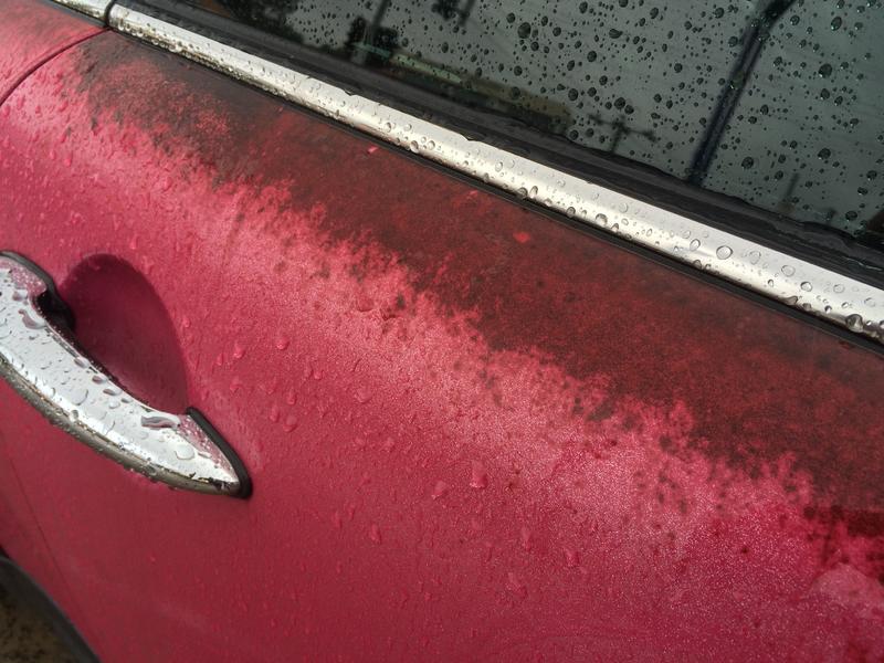

So, she came back a couple months ago with another roll of the film and wanted a removal and replacement of the film..
because this:
so the degradation of the film has discoloured the actual paint pigment underneath the clear coat, but the clear coat was 100% fine!
I've seen cases where the clear coat has been eaten through and the paint been ruined that way, but this was a first for sure!
anyone seen anything like this before?!
I walked her through (again) why it's not worth going with cheaper vinyls as she now will have to eventually deal with either paying for a re-spray if she keeps the car.
I talked her into going through us for materials and we ended up settling with the Avery pink matte and Hexis white/ magenta pearlescent metallic for the roof and stripes.

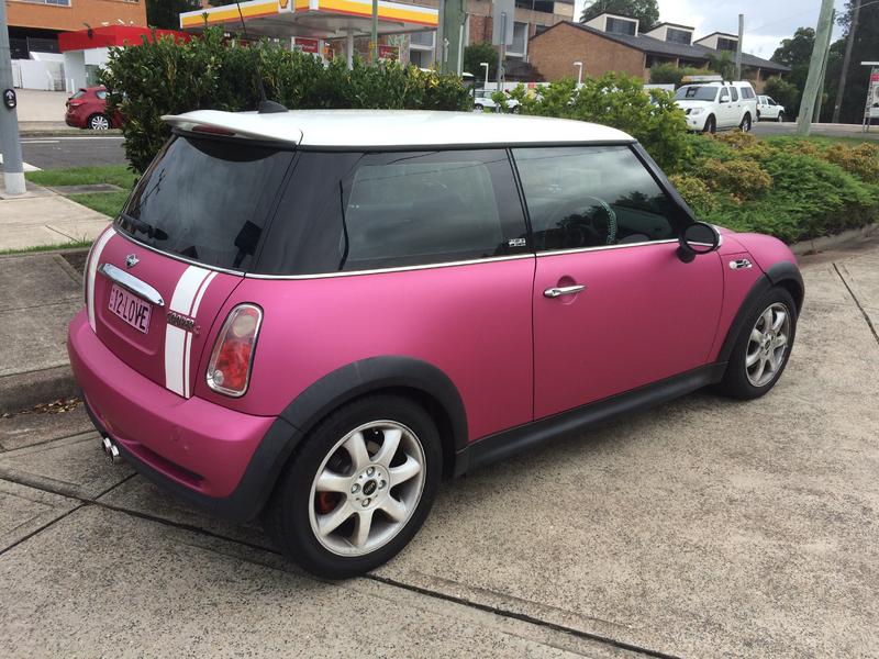

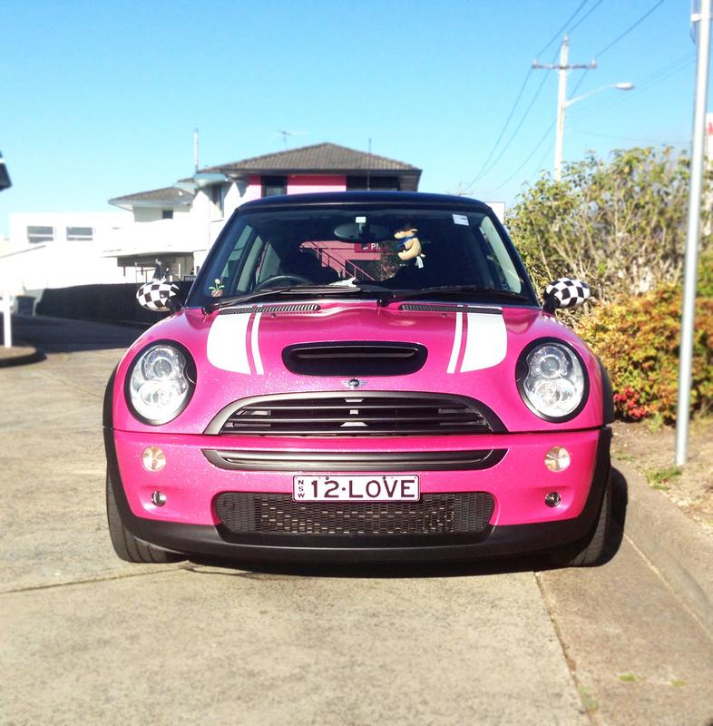

Clem
sorry, this was the final result.. computer wasn't handling

Bretbyron
Crazy! I've painted a lot of cars and have never seen something like that. It almost looks like mold growing. The clear was fine? Factory paints can be thin and crappy, but porous? That's just crazy. Did you try any buffing?
Thanks for posting.
Clem
Thanks for posting.
not a worry, thought this would might've been a unique case study.
Well we were using isopropynol/ avery surface cleaner to remove the adhesive and none of the discolouration was moving then; but no, we didn't try buffing.
Just running your hands over the paint you could feel it was intact, totally smooth.
And it was only the glitter film that did it, the roof was in matte black and was fine, we redid all the matte black elements just to check them out and replaced with 3M 1080 matte black but all non glitter areas were fine.
Very strange

chartle
Very strange
Totally out there idea.
Could the glitter have acted like tiny lenses that only attacked the color coat. Notice how its only on the top of the surfaces. Is this in a super sunny climate like Arizona?
I once bought some clear suction cups and they made a big deal on the package that they didn't act like a lens and concentrate the light. So if you used it a store window it wouldn't possibly fade something hanging behind it.
Just wanted to add both application look great. :rock-n-roll:
lgroth
Give the man a cigar, you hit the nail right on the head! Yes, it was caused by the metallic in the vinyl and the sun. I grew up in the family body shop and owned my own for years before the "digital era"... Look at old cars in the junk yard and most have turned black where the sun hits them hardest with metallic finishes. Most metallic is ground aluminum, it can expand enough when super heated that when it contracts it leaves microscopic air voids which allows the metallic to oxidize. It doesn't just happen under vinyl either, did a custom candy paint job once, heavy gold fleck base, red candy, then put a mix of fine and course fleck in the first few coats of clear... did the same thing by the end of the first summer just because of the few mils of paint between the metallic in base and the clear coat. This usually takes decades to happen in normal paints, sometimes very little depending on climate and vehicle care, but it can be accelerated. Just like older metallic paints (before the clear coat age) were affected by drops of rain (you old timers should remember this) :smile:

So I get where you guys are going with the metallic theory, but what makes the cheaper vinyl cause it when high quality vinyls also have metallic in their range? With that many metallic painted cars out there also I would have thought it would be more common. have seen cars 20 years plus with metallic paint with no signs of this.
SightLine
Its not the brand or quality of the vinyl.... in our own determinations on this type of degradation it is a combination of acids and other pollutants in morning dew, sun exposure, and will be very highly increased on vinyl with heavy heavy metallics like Avery Ultra Metallics. I've seen it a bunch of times here in ther deep south. We get brutal sun over the summer here and I have seen it a ton regular vinyls as well.. It generally only happens on the upper areas like that where it gets the worst of the sun exposure and where dew settles on it. Once it starts changing color you must remove it as soon as possible or it will permanently stain the clear and/or basecoats underneath. The clear coat on the roof of my very own truck is permanently ruined from this and looks exactly the same..... I left Oracal 970RA matte black on too long. My own fault though and I knew better. We have always warned customers that if the vinyl on the roof, hood, trunk, upper edges of the doors, etc starts to turn brown then they need to remove the vinyl immediately as it will not longer protect the paint but will instead quickly begin to cause permanent damage instead.
3M even warns about it in their documents on wrap films.
"Wrap films (just like paint) are degraded by prolonged exposure to sun and atmospheric pollutants, particularly on horizontal surfaces such as the hood, trunk lid and roof. Whenever possible, store the vehicle in a garage or at least in a shaded area during the day. At night, protect the car from dew or rain, which may contain acidic pollutants (a common problem in many large metropolitan areas). When a garage is not available, consider using a cloth car cover at night. If your wrap film starts to discolor or turn brown (which is caused by acidic pollution), immediately have a professional remove the wrap film from the vehicle to avoid staining the underlying paint."
