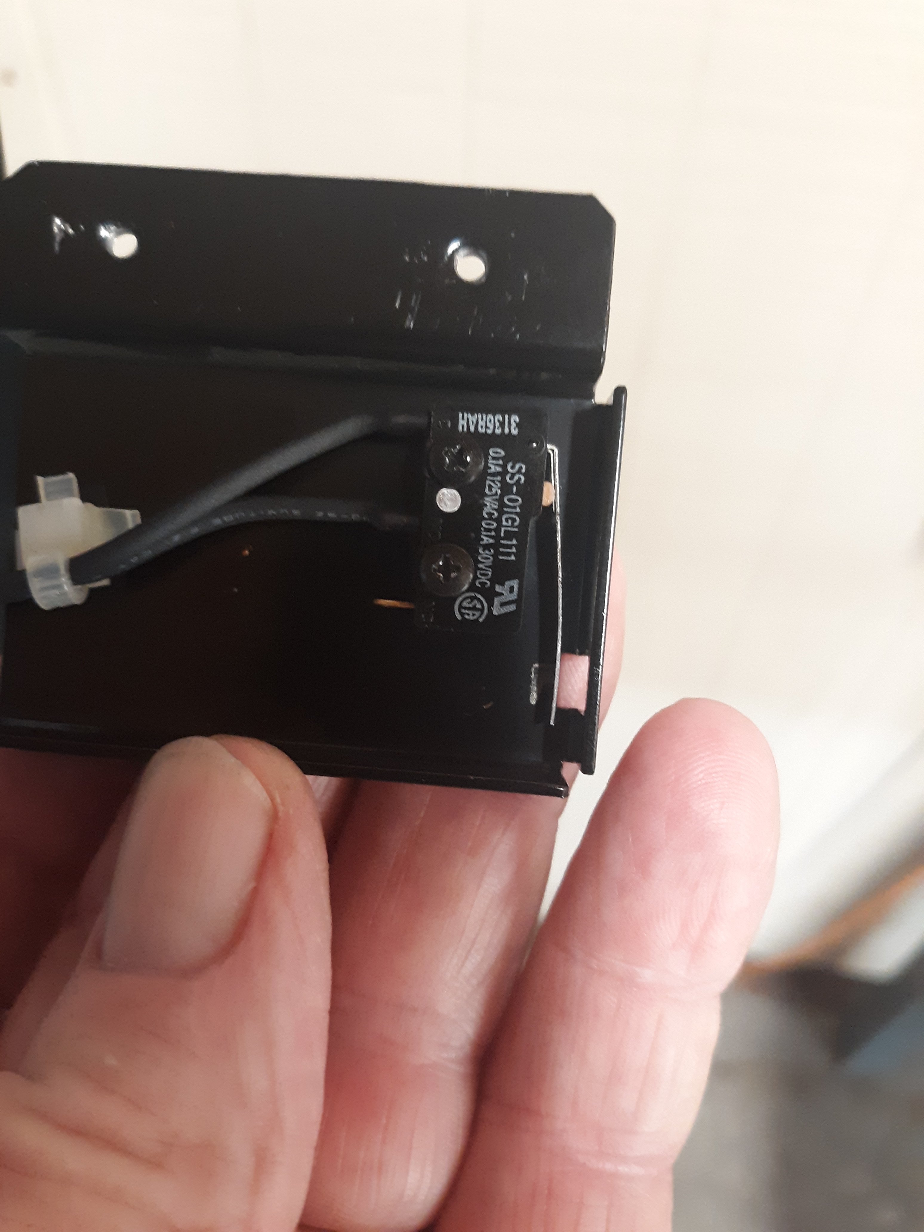

signguy74
here's the sensor for right cover. Still got message when swab was inserted.

those micro-switches can fail. You can try to carefully bend that small metal tab out away a little to make more positive contact, but if you depress it manually and don't feel any actual "click" then the switch is bad and needs to be replaced. Fortunately they're not terribly expensive.

For a temporary fix: Unplug the switch and connect the two wires together, this will close the circuit.
That switch is there for a reason. REPLACE IT
