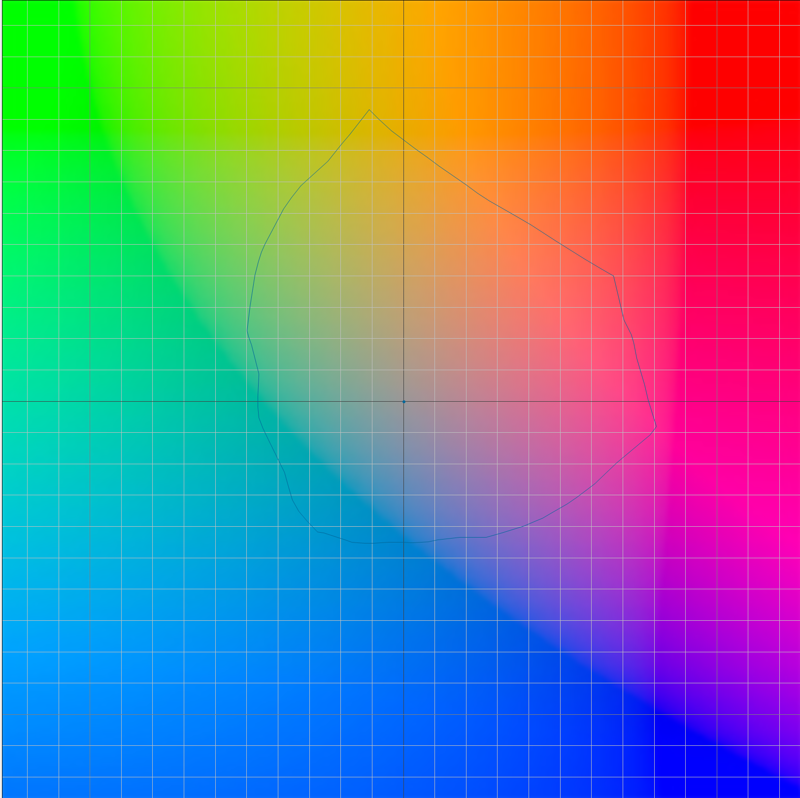

Color Gamut - No Blue

OK. I'll switch to a cheaper media run though a ton of ink and see if anything changes.

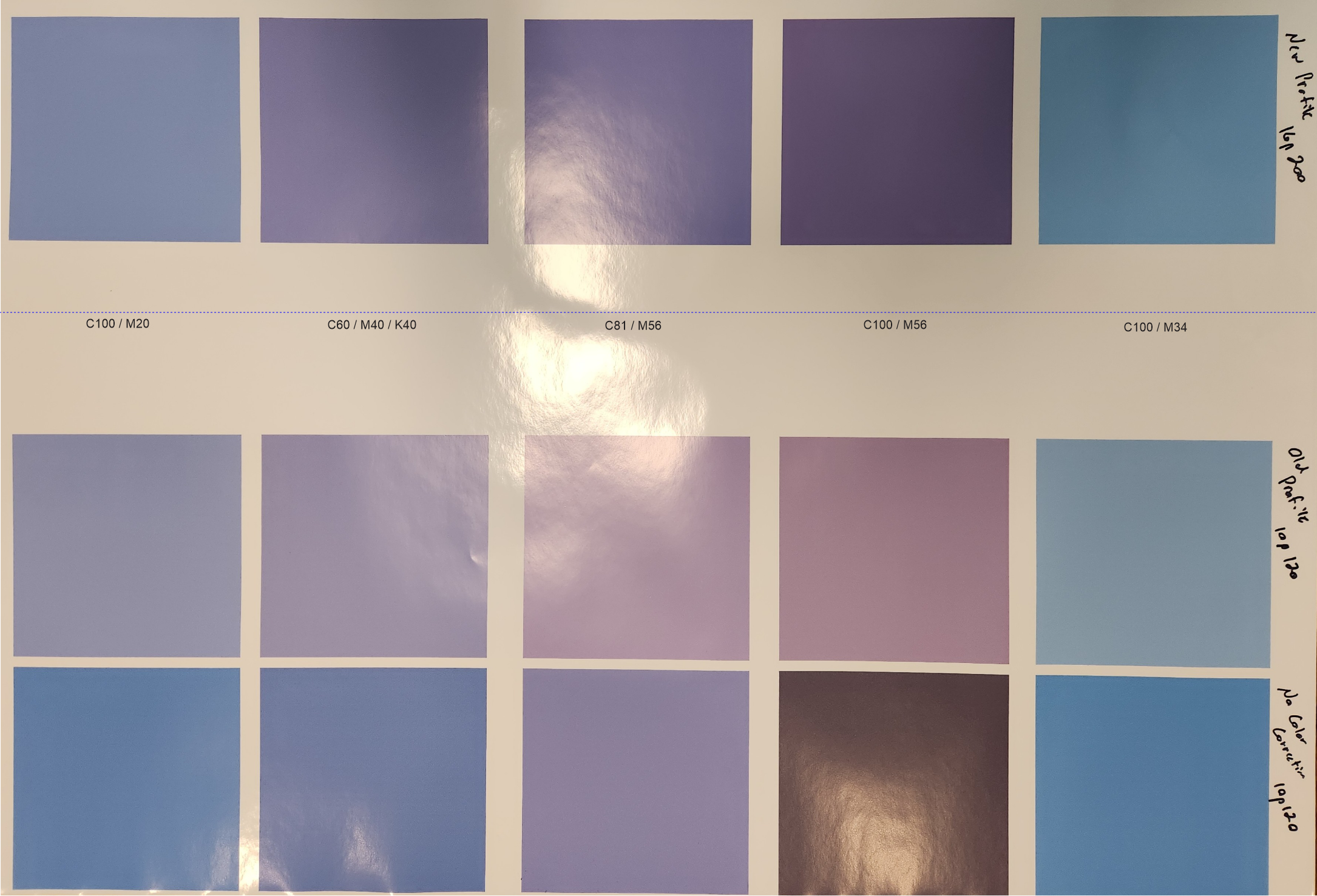

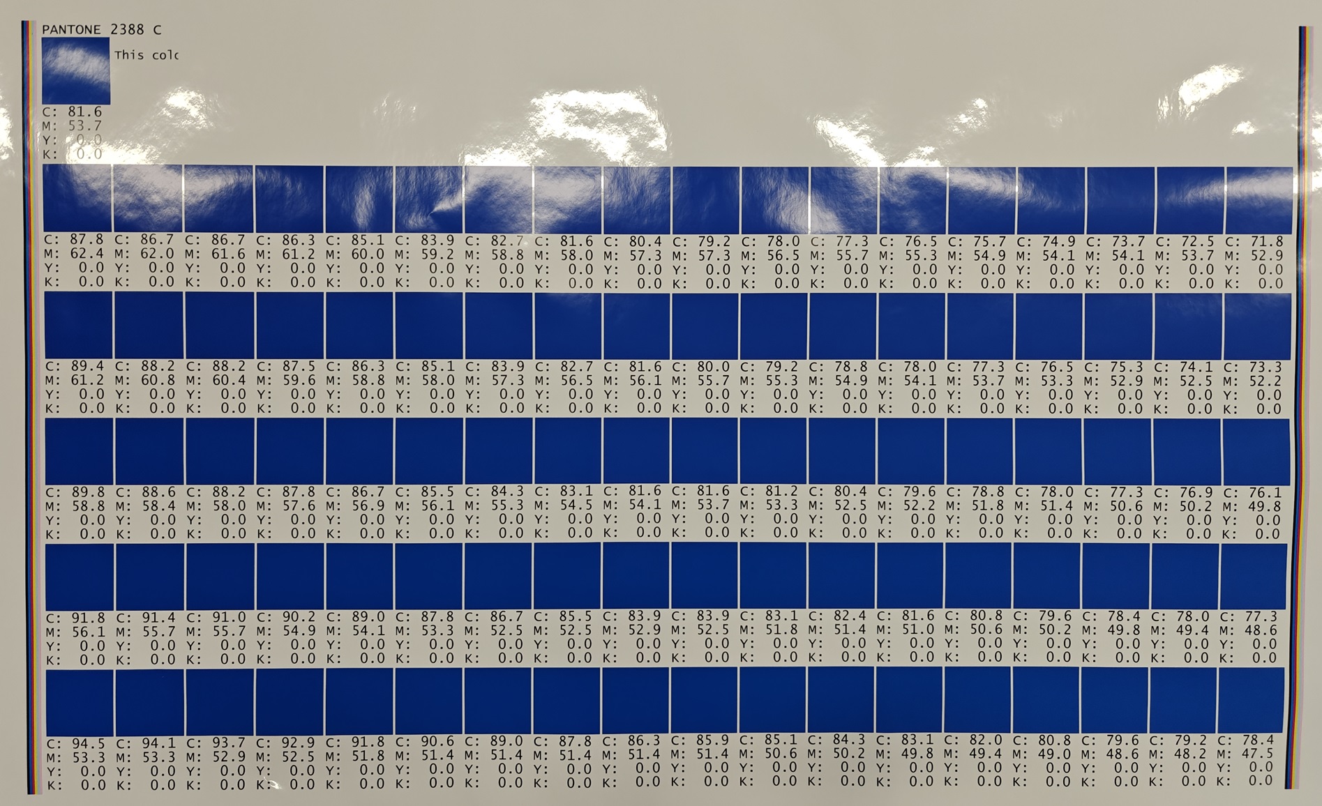

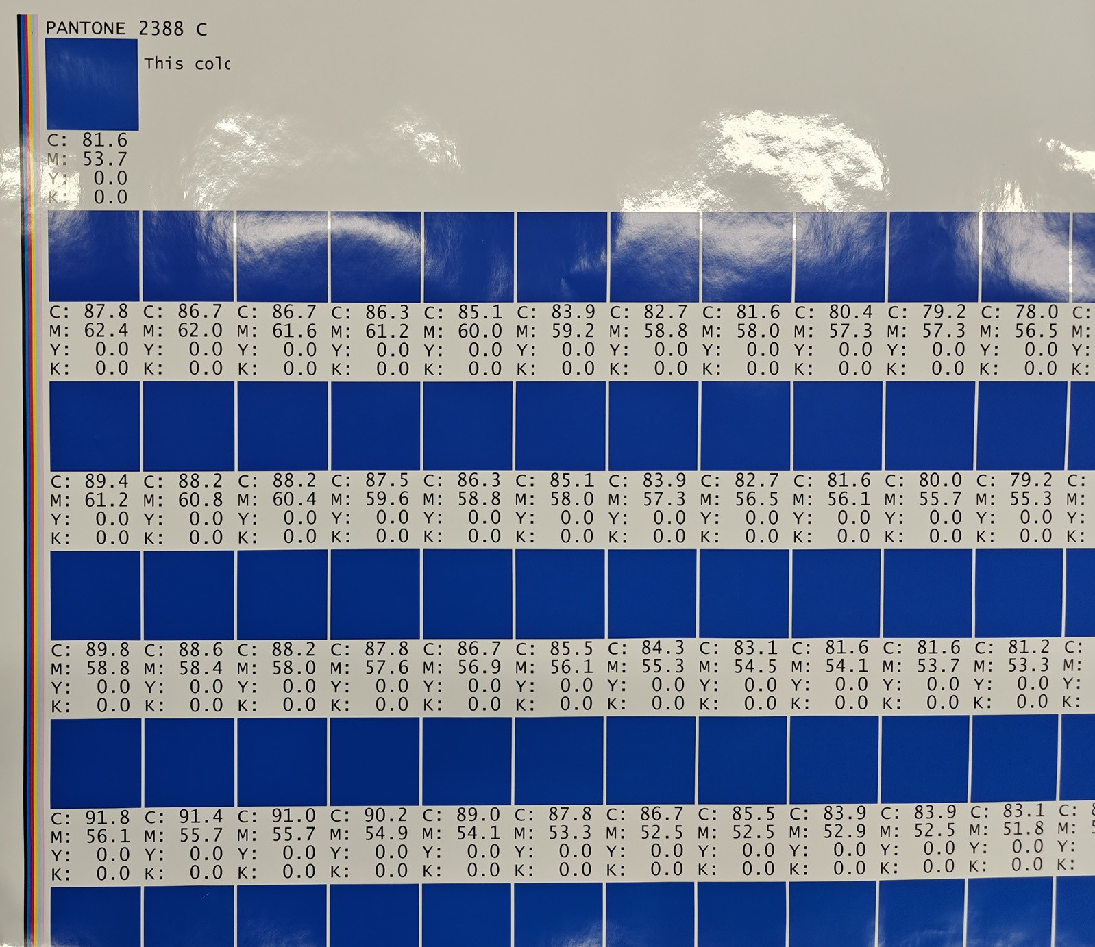

As a test, I decided to create a new file with Corel Draw to eliminate Flex from the issue list.

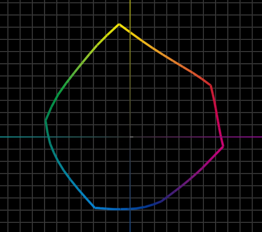

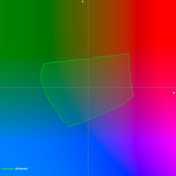

Obviously my white point is way off with my camera. From top to bottom this is my profile that is 16p/200, middle is stock profile 10p/120, and bottom is with no color correction 10p/120. I'm not sure exactly what this means but the blue on the bottom right is getting a little brighter but nowhere close to your blues. It seems to me that the printer is just not spitting out amount of blue that it should whether that is the profile or something with the printer itself.
Is there a way with these printers to turn LC/LM off completely? Does the picture above tell you anything?

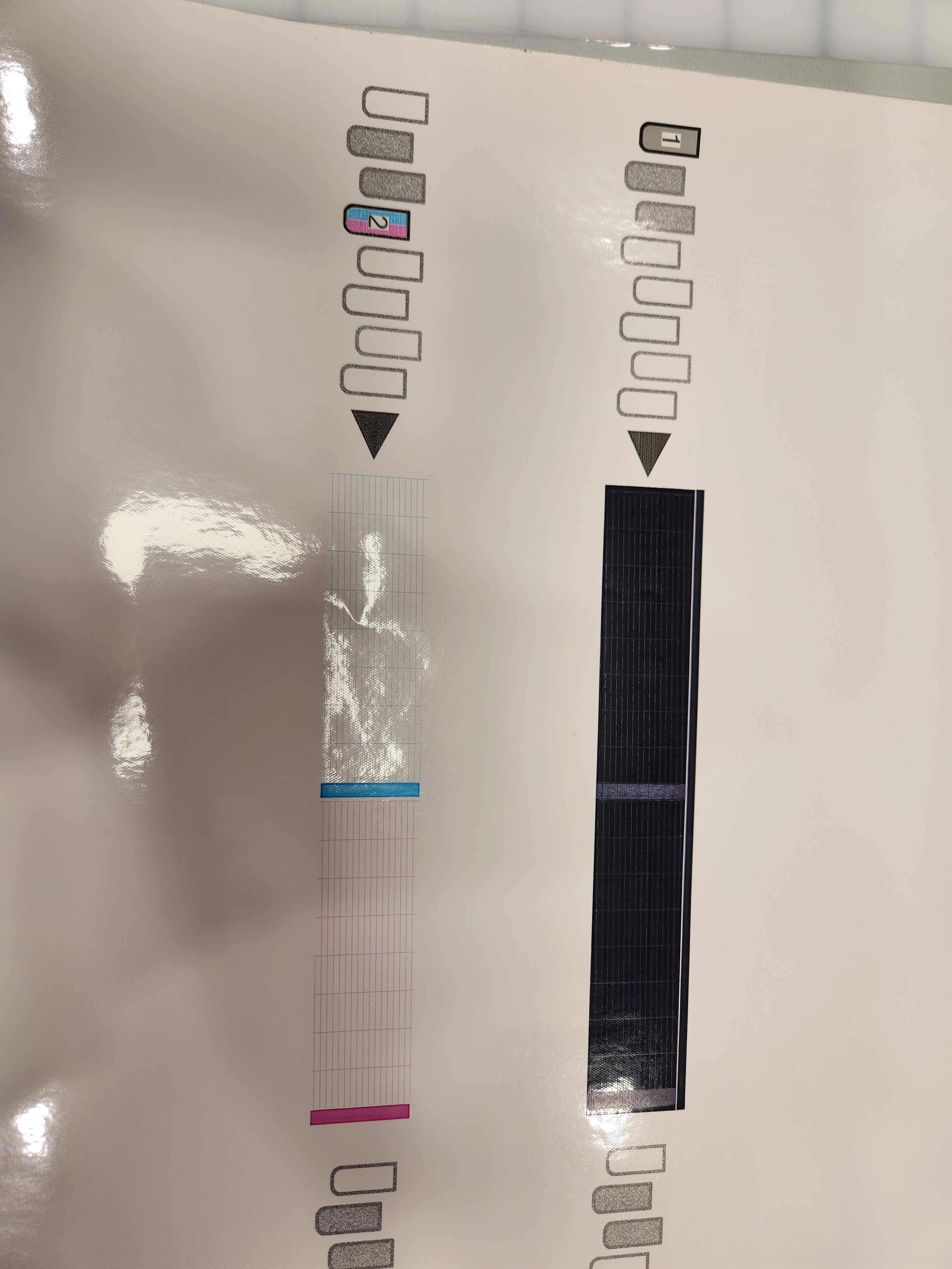

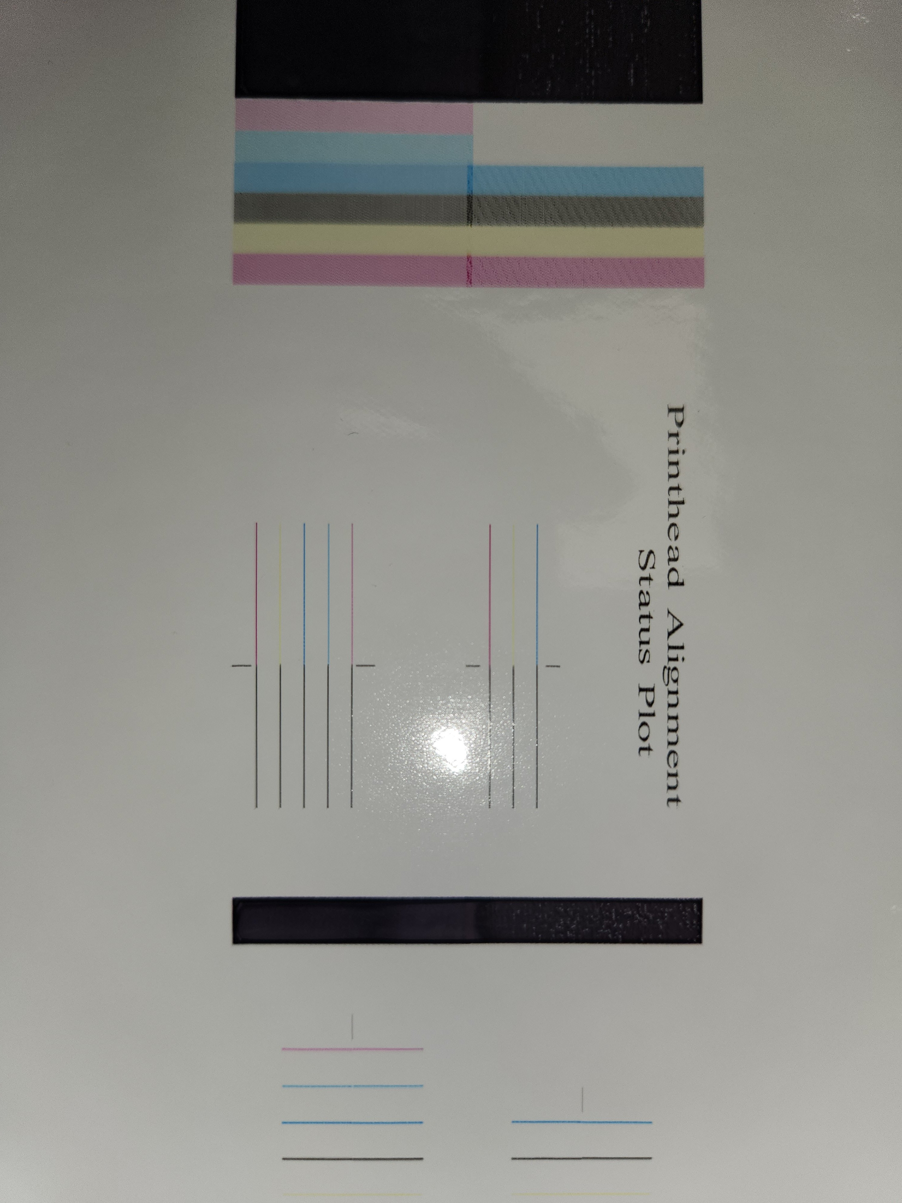

It just feels like you have a issue with the ink but.... Can you print the nozzle map and take good pictures of it? Especially lets compare LC and C on it.
HP control print from the same menu would help us as well. We can rule out everything else and just check the printer.

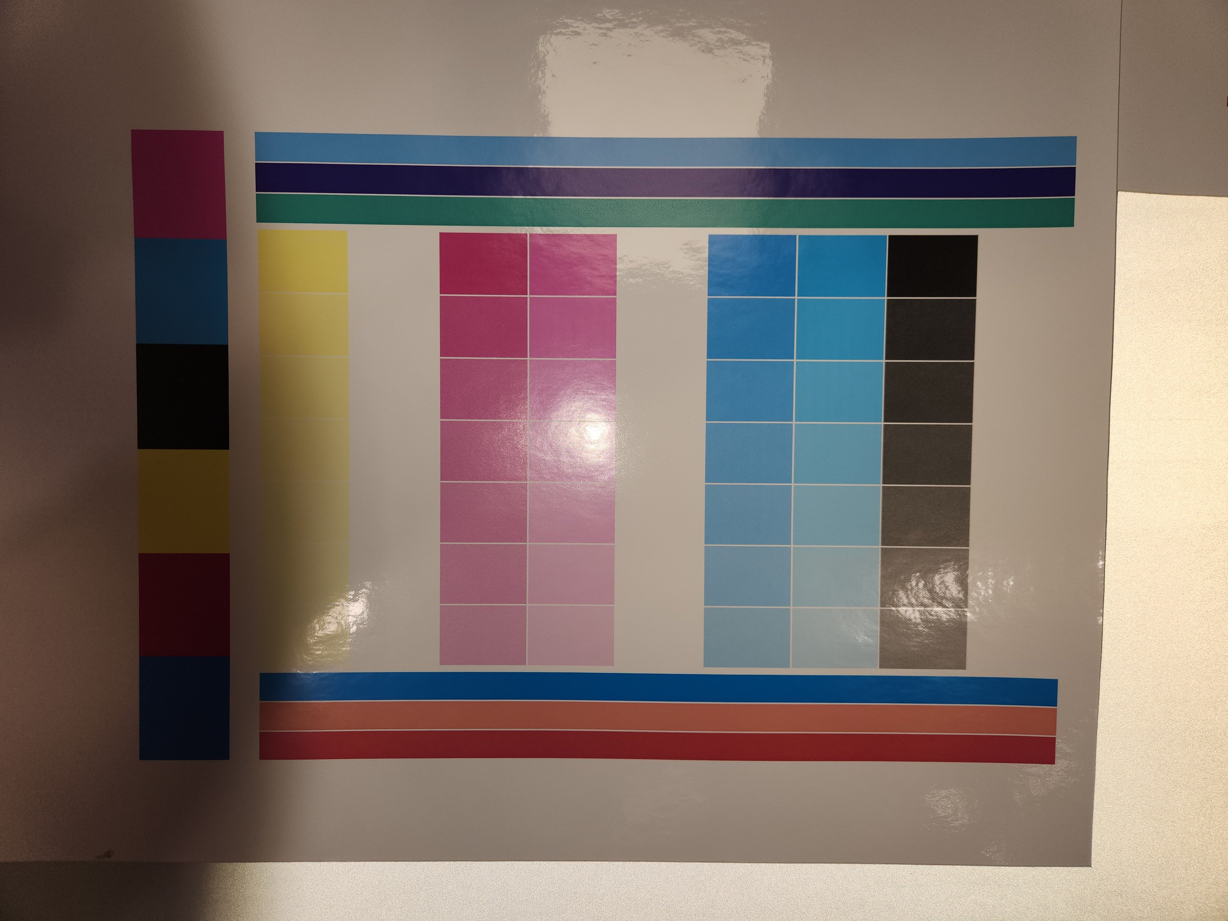

Print the Color Calibration chart and post it. It contains ramps for all 6 inks and makes it easy to see what is going on with inks - see attached for the chart.

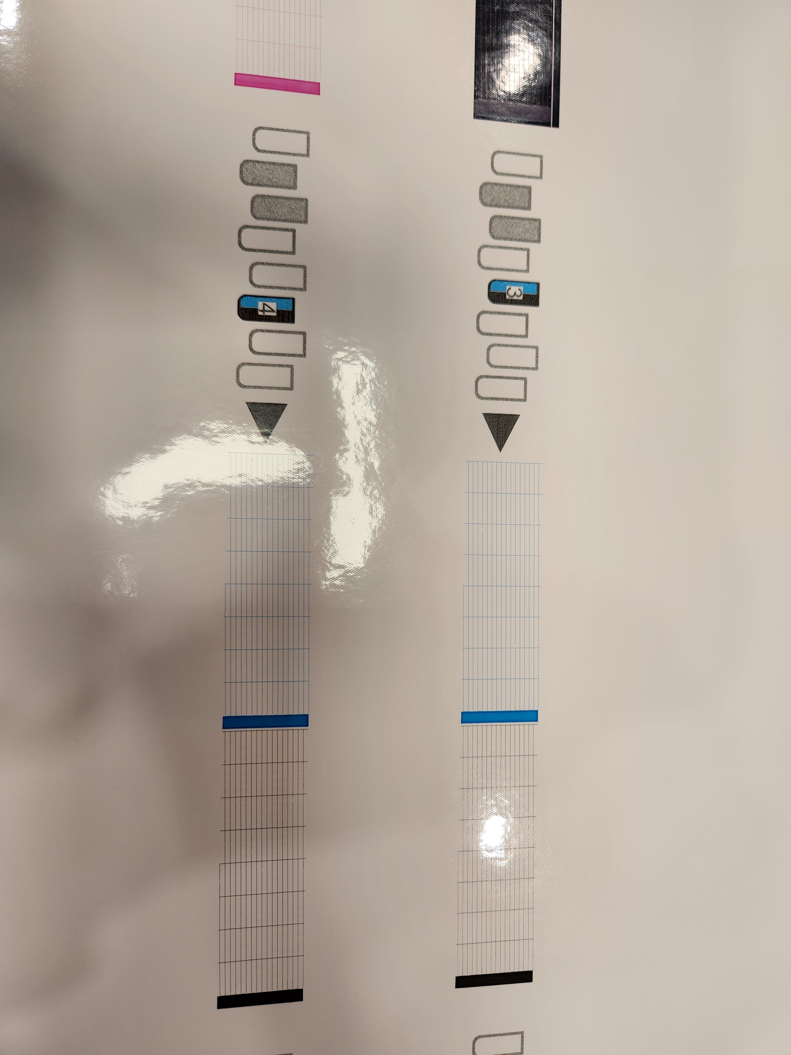

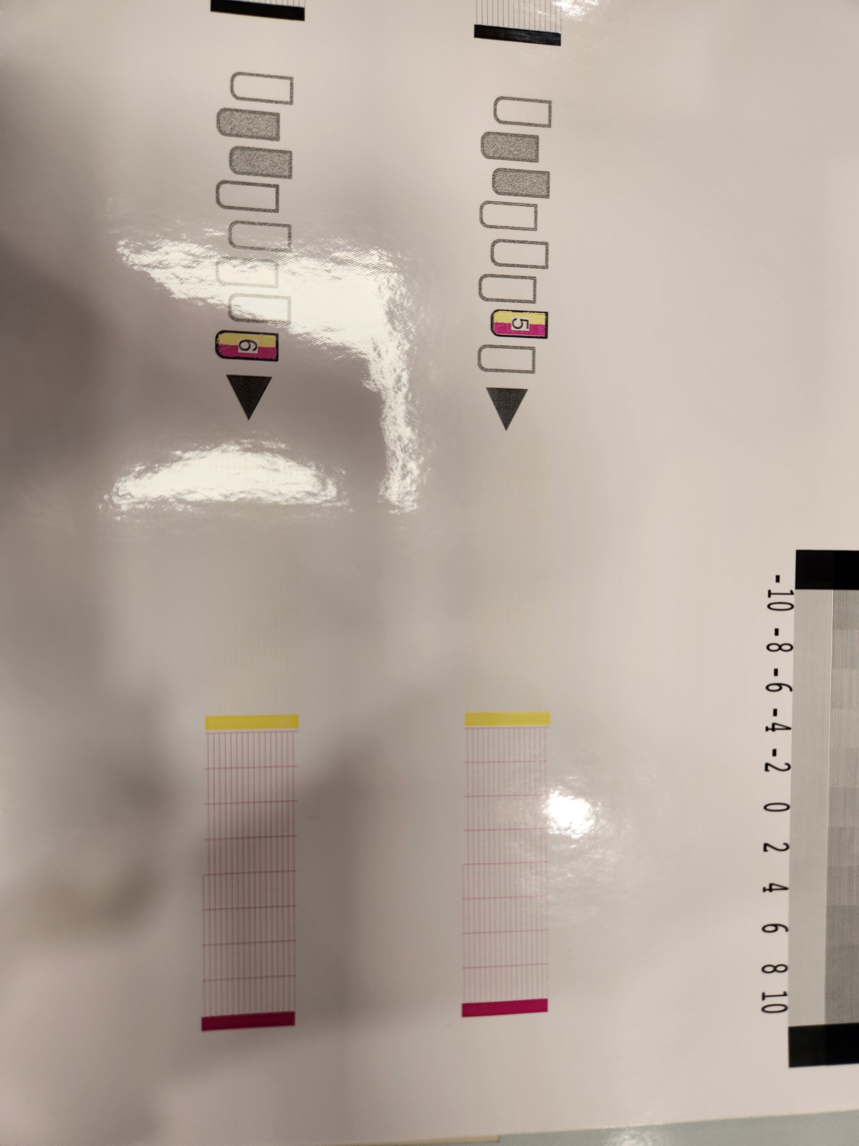

Here are the results of the different tests.
The yellow is extremely hard to see but it is there. All of the heads look like they line up perfectly. The color calibration chart looks fine to me but it did before, the cyan just was not near as dark now that I compare it to an older one.
