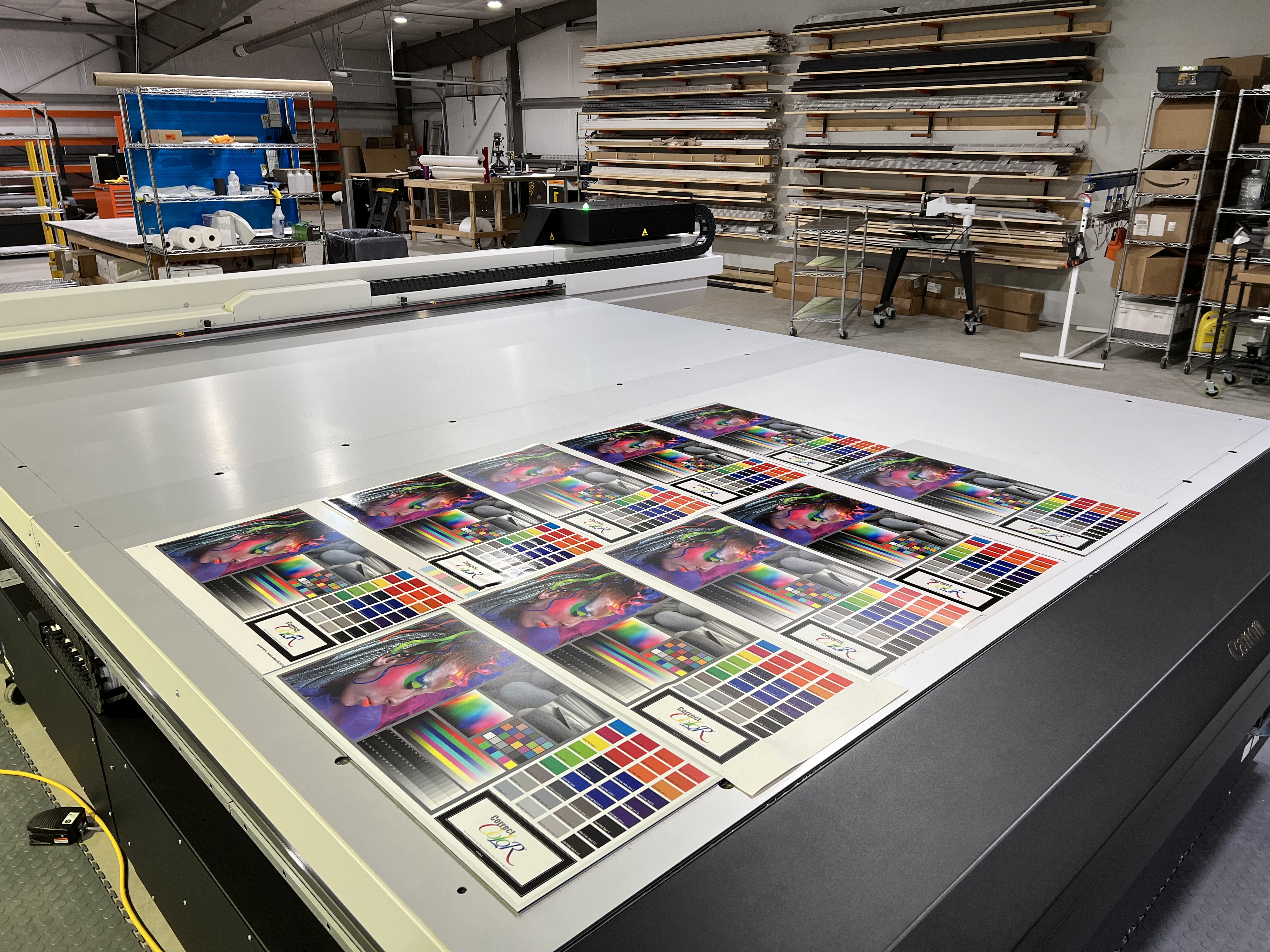

That is the infamous alien girl image. It is often used to proof color setup. If you can print her face you can print about anything. The Granger Rainbow is even more difficult to print smoothly.
We recently had Mike Adams from Correct Color come and profile all our machines to match. We had 10 or 12 different media across 6 printers from different mfg which included sublimation, roll media and several rigid substrates. Learned more in three days than I did building profiles for 20 years. Mike is good at color.
Attached is the resulting test prints. If we had printed these before he started it would have looked pretty sad even though customers loved our colors.
Good luck.

how did he accomplish it? did he create one universal profile that all the machines could hit?
i really intend to do that myself before the end of the year. but i am a bit afraid of reaching the point where none of the machines are printing as well as when i started.
i have quite a bit of experience color matching in other industries (broadcast color tv cameras, in the 1980's & photographic processors and silver based printers in the 1990's)
it occurs to me that sometimes you are better off if you do not have prior experience in other industries...

I’ve done my own profiles for 15 years as well. Didn’t know what I didn’t know. He used a special profiling tool so the same engine created the profiles for everything.
One thing for sure, the rip built profiles where deficient in different ways on each of our 3 rips. Especially the greens and yellows.
Also did some magic on the ink curves that gave us dramatic improvements in print quality. Tonality in light areas and color gradients is much better than we were getting. Not quite as good as the lightjet and chemical process but pretty dang close. Our acrylic prints using thr light inks have substantially smoother tonality compared to our own profiles.
He has some videos on his youtube channel that go into more detail about what he does. I think he calls them the color movies or something. Search correctcolor.org in youtube.
