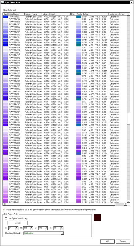

Check my thread- http://www.signs101.com/forums/show...issues-with-Versaworks-and-Roland-spot-colors
and see if it is what you are experiencing. I am working with Roland tech thru my local tech on this problem now. And it does seem to
be the darker colors. They sent me a spot color chart to print- check the differences between the library cmyk and what is sent to the
printer. BTW I got VW 5.2 with my RF640 ( same as a VS except no cutter ) and tried updating to 5.3.2. Gene
