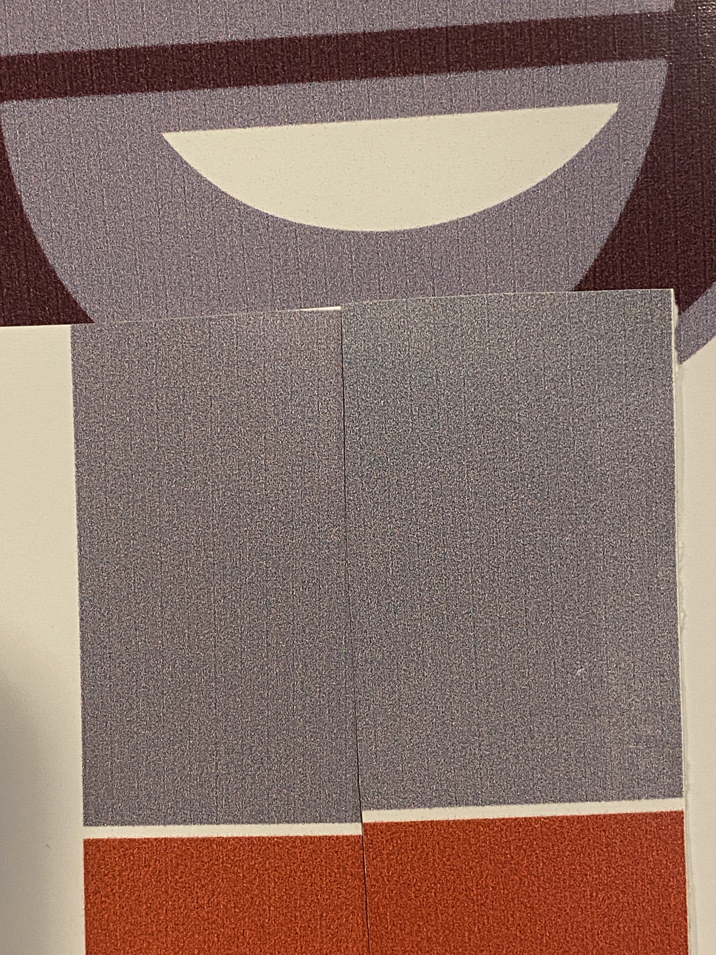

This is a problem I've had since I've owned my machine.I have a Roland VP540i. I'm using 3M 180. I have a 4 color design. This is a repeat customer (my best customer) and everytime they get new trucks in I go to print using the same material, same profile, same everything and the gray comes out different every time. I have to spend hours tweaking the color to match the original, then change the file to the new colors. Today, I spent several hours doing that. I got a gray the was "close enough" , changed the design file to the new gray and printed it and it was noticeably differerent. I then reprinted the test print again and it was different from the first test. So I have 3 different grays: the first test print, the file print and the second test print. Nothing has changed... same roll of material, same temperature in the room, same profile. I double checked everything. I'm at my wits end. Please help.
It's more noticeable in real life than it is in the picture, but you can see the difference

Due to many factors, printers will drift in color over time. There's a process called, "linearization," that allows you to bring it back it's original state but that requires a spectrophotometer. I've even seen two of the exact same model printer, in the same room, installed on the same day, same file and media etc. and they printed different colors.
