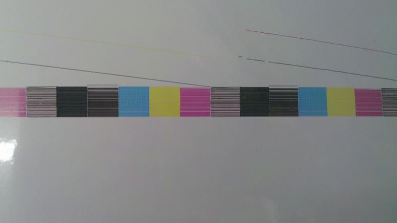

Here is my nozzle check if this helps at all.

Cross contamination?
+1
What happens if you run 3 test prints back to back? Does it clear up by the last one and start printing correctly?
I had that happen before and ultimately the sponges on the capping station were swelled up so I ended up removing them until I got a new capping station and actually ran it that way for about 3 months.
So now every once in a while I will take a lint free cloth and press it lightly on the capping station to wick away some of the excess ink that is left behind from the daily cleaning.
randya
Yes, and you still have quite a few missing or misdirected nozzles.
Head soak, head soak, head soak.
No they look the same
I have recovered one nozzle since the post now I am still working on the last one. UGH I am not taking this mother apart again.
randya
Check for a leak at the damper connection.
Worn oring, too loose, too tight
Do you have bubbles in the air line from the cart to the dampers?
