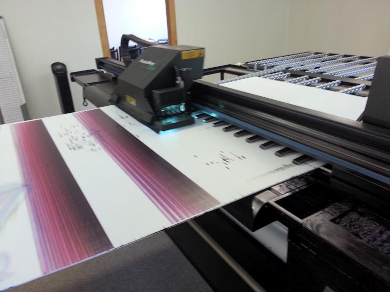

Just moved and reinstalled our UVR and now the Prime Bars won't print at all. The print recovers jet pattern does print. Anyone know what the #$()) might be going on?!

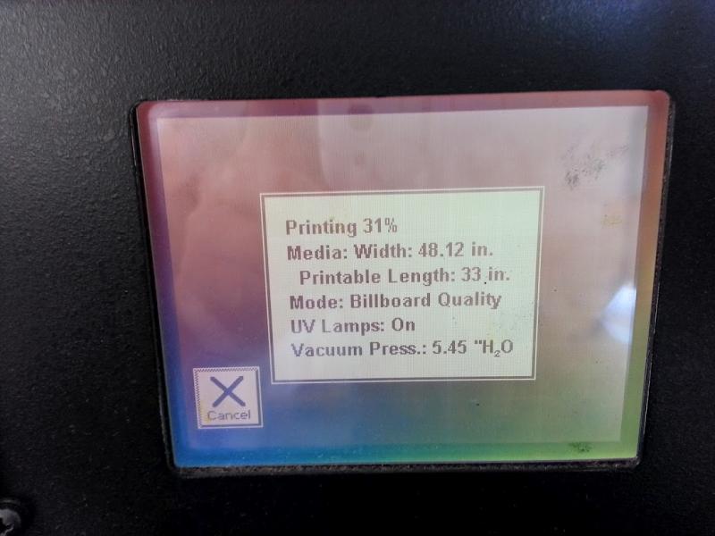

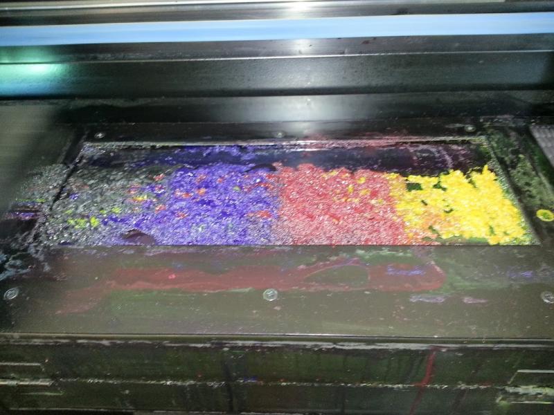

Pictures of what is going on... Please please please help.

you should not be seeing that much ink on your drip tray, I would wager that you have an overfilled head or another vacuum problem. Is there ink in your vacuum tubes above the heads?
