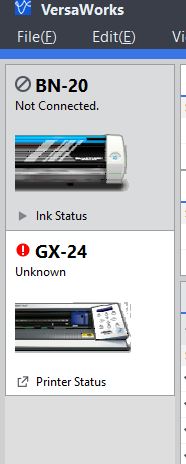

We are new at this forum and already have learned a lot and read interesting things that can help us. Thank you for that!
We own a Roland BN-20 printer and a Roland GX-24 plotter.
Normally we do not use the GX-24 any more, but now we have a lot of printing and cutting jobs and like to use this machine again.
Then we can print with the BN-20 and let de GX-24 do all the cutting work with the crop marks.
We do have an issue with our GX-24 in Versaworks. We cannot seem to connect the GX-24 with Versaworks.
The printer status in Versaworks is always "unkown".
The plotter works and has connection with the computer, because in the cutstudio we can do a cutting job.
Does anyone of you had the same troubles and did you get to solve it?
If so, how? We would be very grateful if you could help us out with this.

Thank you Creek Bank, but it is a GX-24, not the GS-24. And there seems to be the problem. Our technician of our supplier is occupied with it, after several attempts, still no solution. He is in contact with Roland now to solve it. If the GX-24 is possible to work with Versaworks 6 and Windows 10. We shall see.
