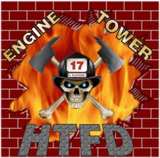

Created an image using Corel Paint and imported into Corel Draw (using x3)
First image below shows graphic as it is on screen (exported to jpg)

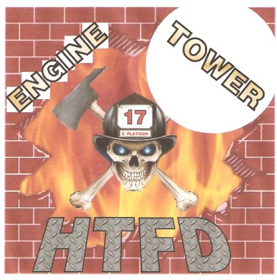

When I go to print it out on my regular inkjet printer I get the second image note the whited out areas around the word "Engine" and "Tower"
any idea what could be causing this? It doesnt show like this on the print preview (only when it outputs to my printer)

rasterize it first?
or check overprint settings...it has something to do with the gradients...linear on the left and radial on the right
captainron19
Dang - that was probably the fastest reply I had to a question - I just printed out again and selected rasterize in the print window and it came out fine.
Never had to do that before - and really no experience with it. Is it something I should have checked off all of the time?
