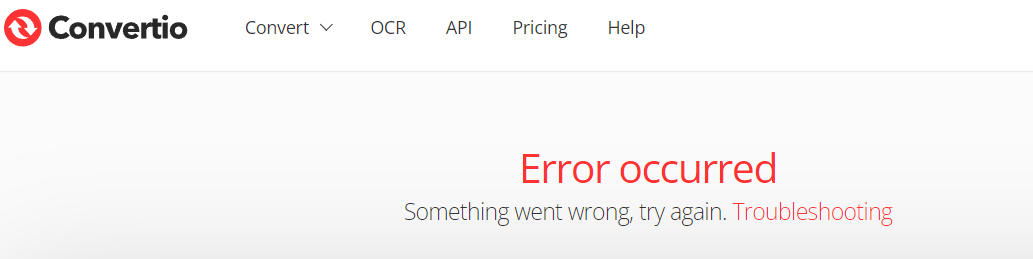

None of these solutions work unless you have a copy of corel. There is a website called convertio that says it can convert a cdr file to other formats. I realize that it likely will not correctly convert complex fills or special effects but has anyone tried it to see how well it works with basic vector graphics from corel to say ai, pdf or eps? I don't have coreldraw to test it out but maybe this will work sometimes even if the best it can do is convert into a bitmapped image to view or trace
Boudica
I just tried it with one of G2B's files, but it didn't work
