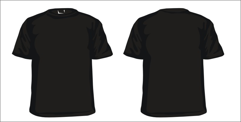

I apologize if this has been covered before.
This is something that has bugged me about X3, but I just lived with it. I'm sure it's just a setting somewhere.
Why do all objects have these thin white outlines around them? How do I fix it?
Example:
rcook99
Phillip, Have you tried to click on the no outline icon? I had a similar problem before when I checked no outline it went away.
Bob
Jackpine
It will only have an outline if it is a vector. Right click mouse button over the X at the beginning or top of a color palette or in the "pen" flyout tool.

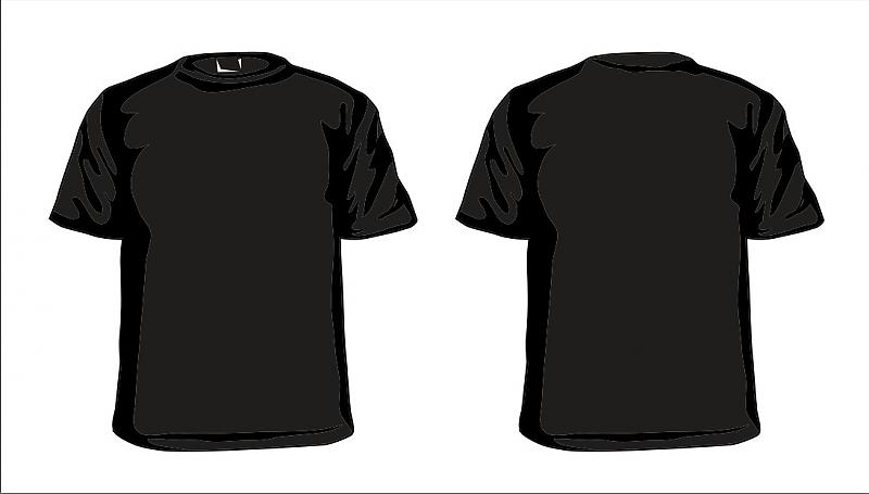

neato
No, there is no outline. These are layered pieces on top of each other.
I've used 3 different versions of X3 on 2 computers and they all did the same thing. Here's the same graphic copied and pasted into Corel 12...

dclet
are you viewing it in "enhanced" ? try normal. I find certain display adapters do this more then others(upgrade your drivers maybe)..it's a well documented antialias' bug in corel...
neato
Aha! That's it! I should have asked that a long time ago. It was set to View as Enhanced With Overprints.
I guess I'm surprised that the view affected output. Oh well. It's fixed.
Thanks!
