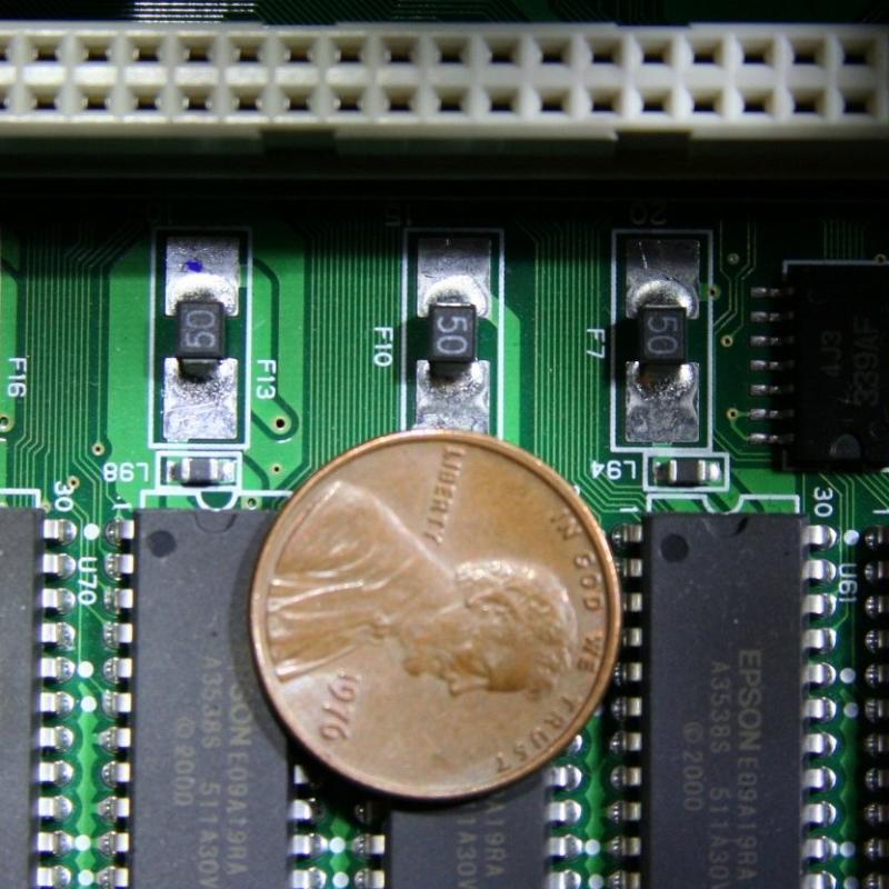

Need some help finding correct fuse for my Falcon Outdoor II, Mutoh Part # MF-5012
My dist. called Mutoh and they said it was a 2 amp fuse, which they do not stock,
Suggested I just use a generic replacement fuse,
The people at GEI Wide format said it was a 5 amp fuse and they would have to order it from Mutoh.
So now I am unsure exactly which fuse size I need, I've attached a pic of fuse, Its a surface mount fuse with the number "50" on top.
Any input would be appreciated,
thanks

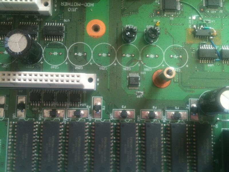

TW3
We just had to replace our fuses on our 62" Mutoh printer. We took the board out and took it to GEI Wide Format in Canton, Ohio. They took the little black soldered fuses that also had 50 marked on the top of the fuse and replaced them by soldering little fuse holders onto the board. We can now replace the fuses by hand without having to solder them in next time. They put in fuses that are now white fuses. GEI Wide Format of Canton told us the fuses are 2 amp fuses. I hope this will help you out.

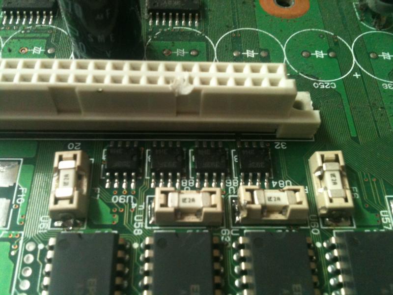

Just want to thank everyone for help,
I finally figured out that the correct fuse was a 2 amp Fast Blo type fuse,
Seems some Mutoh models use a 2 amp or 5 amp,
My Falcon Outdoor II should have a 2 amp , I've attached some before and after pics of
replaced fuses, I order fuses from FusesUnlimited, The actual part was a LittleFuse
0154002, It was the holder and fuse, Took the motherboard to my local RadioShack guy and he did a good job replacing fuses. Now if fuses blow they can be replaced without any soldering or etc.
