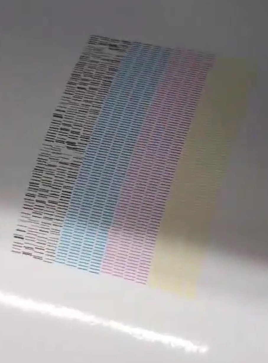

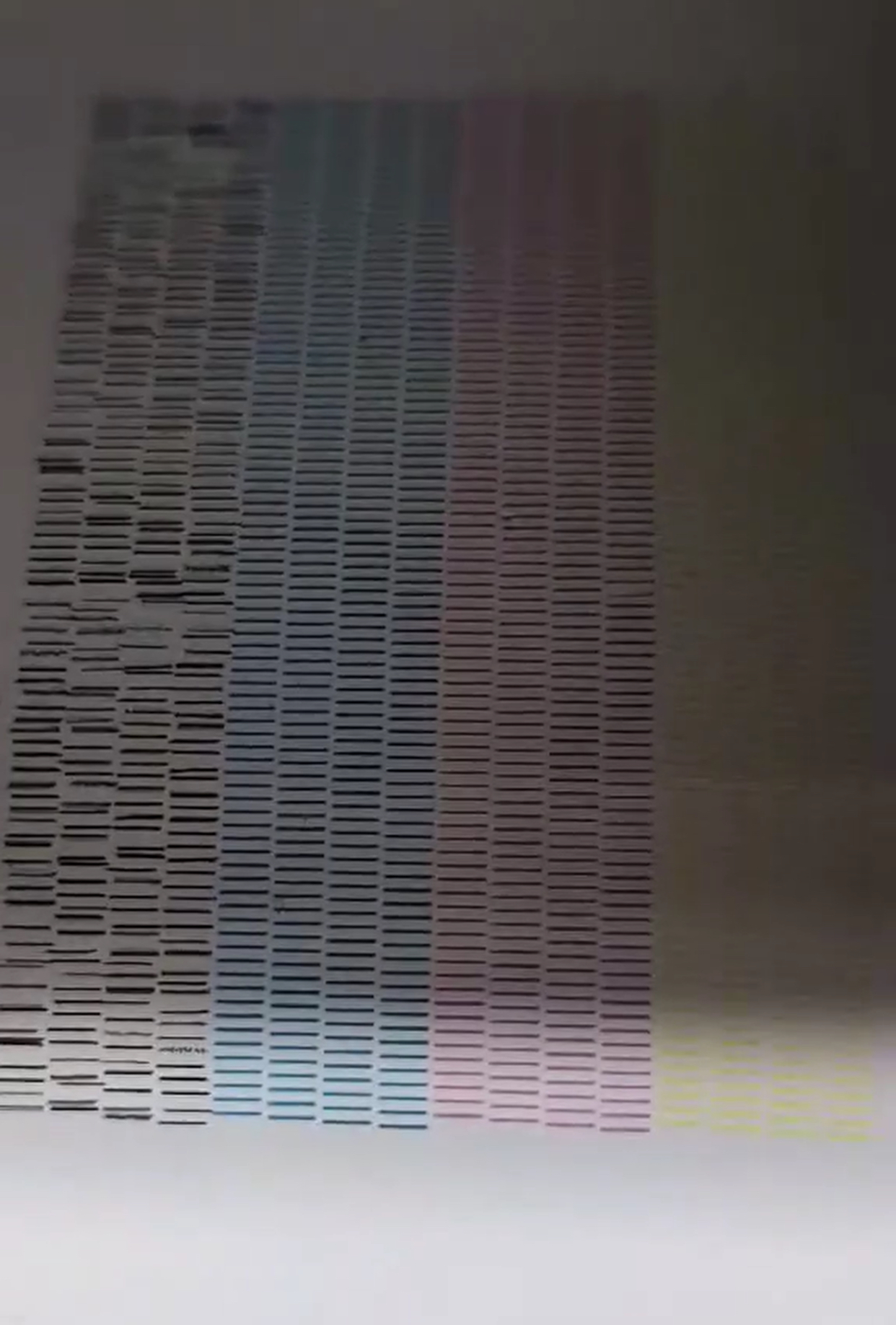

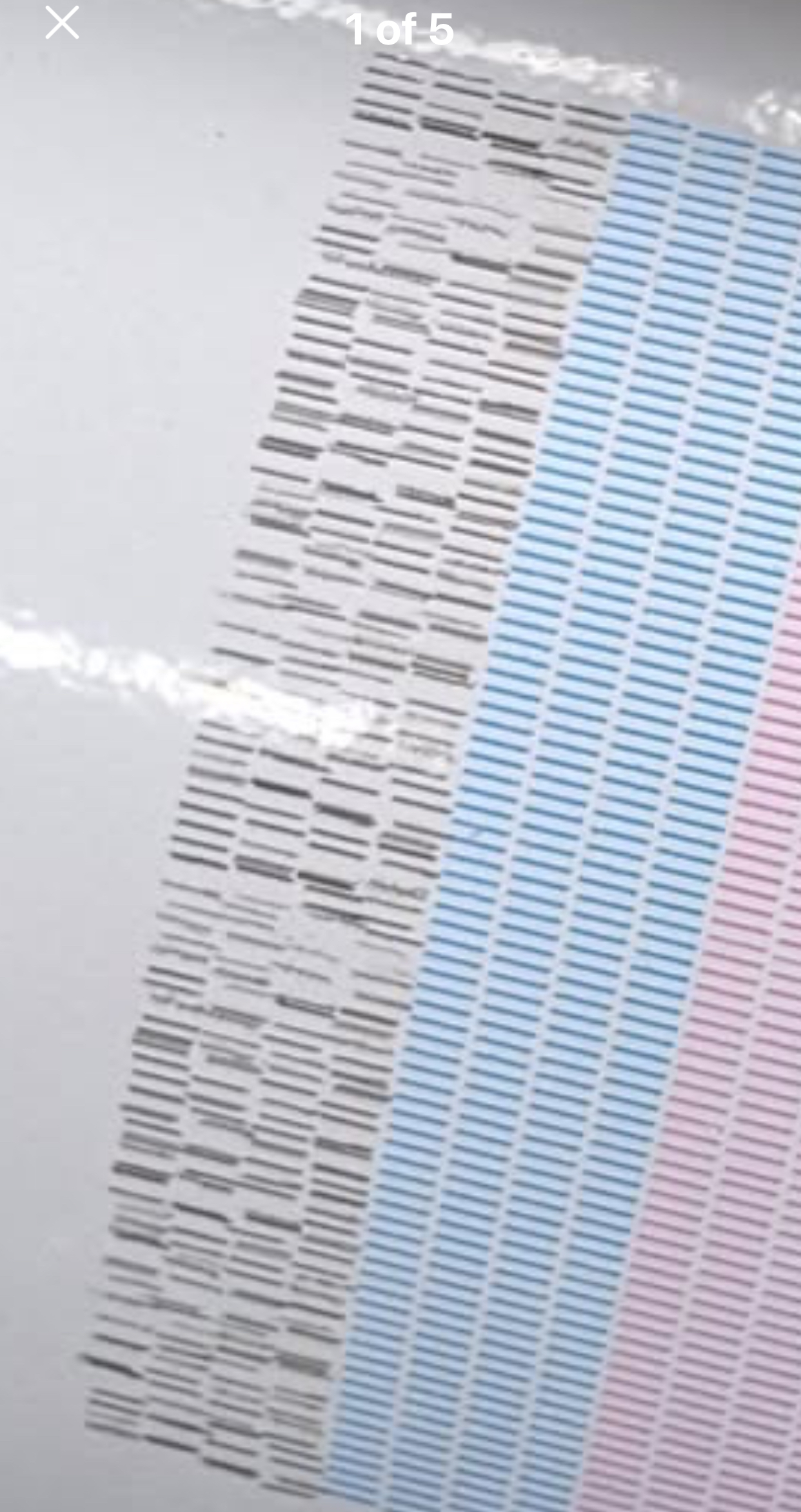

I’m looking at a sp540v and have never used this machine before. I’ve only had valuejets in the past. The print is coming out very blotchy that I was sent.
I’m hesitant to buy it. Even if the price is right.
midnightmadman
Does the alignment look ok ?
It’s so different than what I’m used to using on mutoh printers.
What is causing the black check to look like that?

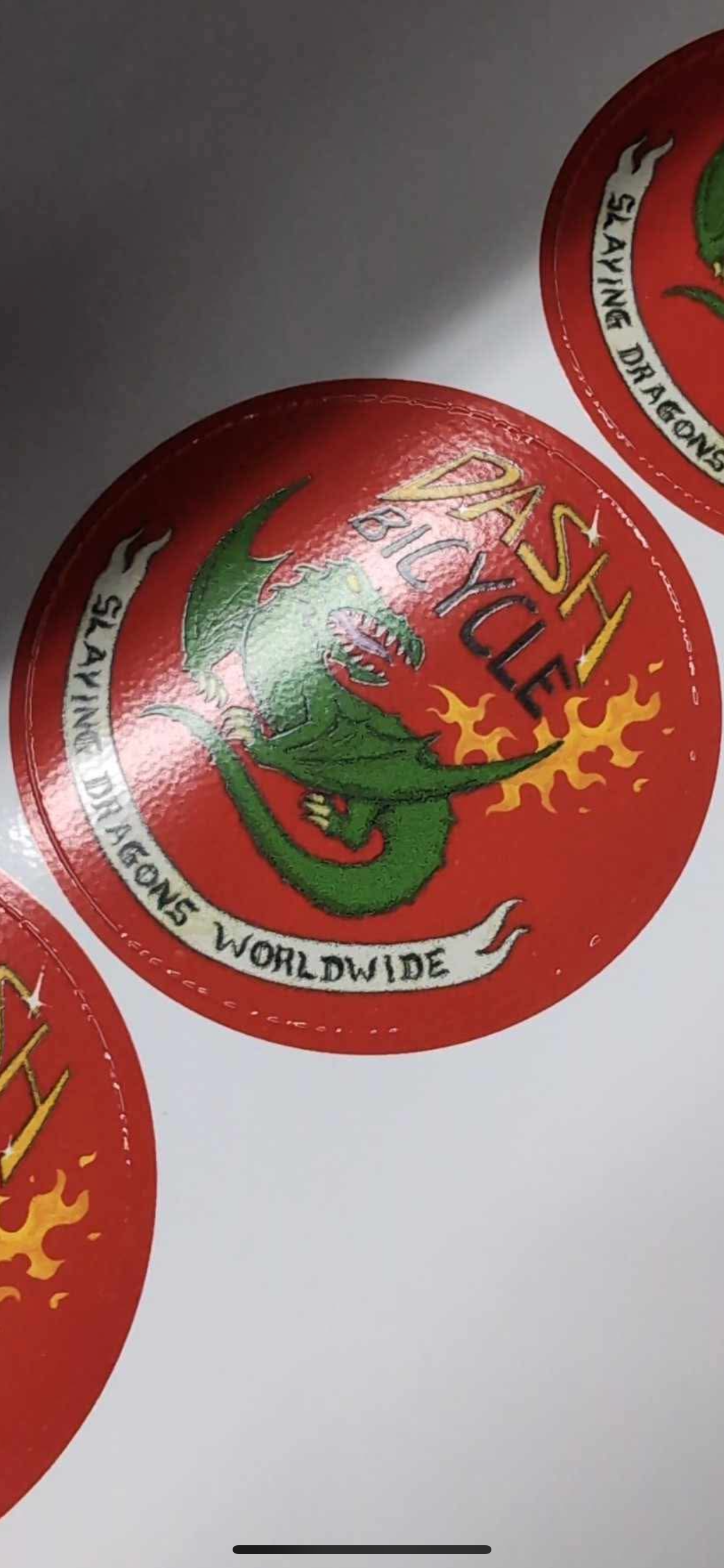

The print I was sent looks terrible. I’ll attach it.
Smoke_Jaguar
Virtually every black nozzle on a head deflecting, either something wonky is going on electrically, or might've been something that bonked the printhead if I were to take a stab at it.
New head would likely fix the issue, so budget accordingly if you plan on getting it.
Smoke_Jaguar
Leaning towards mechanical but probably needs a head regardless. If the head is already new, might be a big red flag.

Why is it printing but jogged all over the place like it is ? If the head was clogged wouldn’t the lines just be missing not all staggered and crazy looking like that ?
He said the heads are 5 years old.
damonCA21
Definite;y needs a new head, knock at least $1500 off the price if you can't fit it yourself and need to get a tech to do it.
To me it either looks like extreme clogging someone has tried to fix badly and it has damaged the nozzles, or the plate is starting to lift and causing the deflection. There is pretty much zero chance of ever getting a decent print out of it without replacing.

This is common with the older Roland printers using DX4 heads and the Roland EcoSol black ink. I've seen this dozens and dozens of times and a new head always fixes the issue. The carbon black pigment is rougher on the DX4 head internals than the pigments in the other colors. Replace the head, and the dampers at the same time... Definitely not an electronic issue, just degradation from the black ink...
