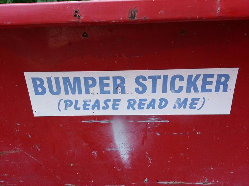

+1 on the O.3641 But I've never laminated bumper stickers. On several occasions I've stuck extra's on my shop truck to monitor the durability and they usually look fine for about three years. I can't imagine what kind of vinyl would go bad after three months. IJ11 maybe?

Printed and applied this the first week after I bought my Roland in 2008. No laminate. It was originally process blue. Inside wall of the truck bed.
