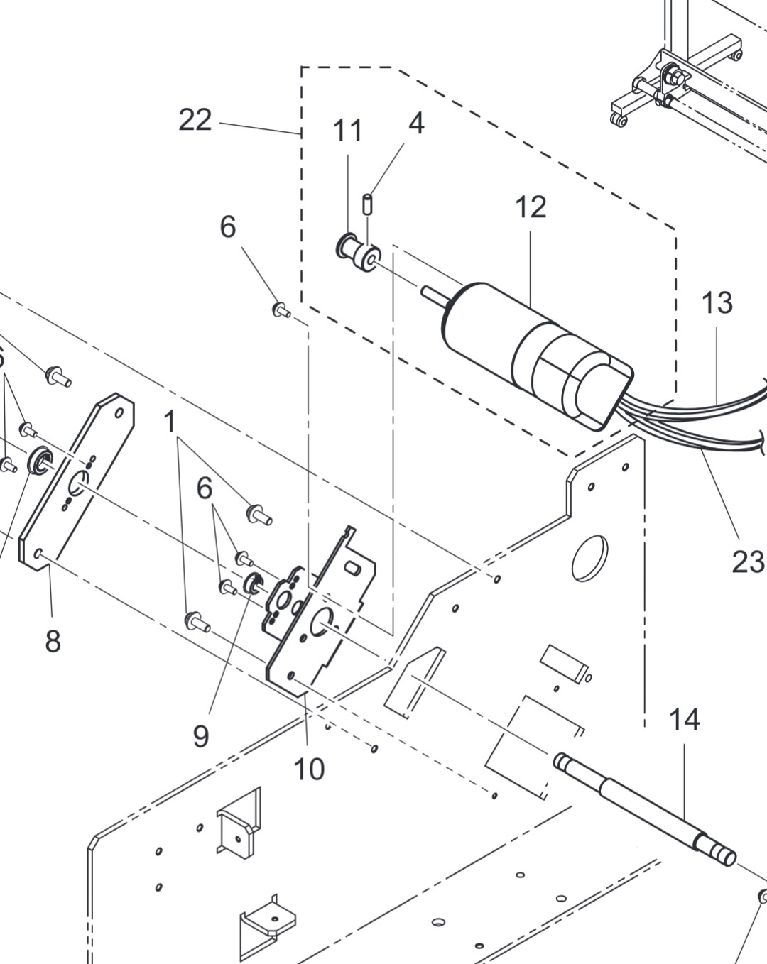

unmateria
Hi :) tight 4 and check pulley and belt on 11

unmateria
When belts and pulleys are not ok or loose, there are backslash errors. Begin cuting ok, but the errors go in increase every time it goes fordward and returns. if u want to do a quick check before opening the machine, just add a big weight with tape to the hanging vynil. If the result is better or perfect, just check belts and tight 4 and the other pulley

unmateria
Maybe i looked the manual too fast on mobile at 5am hahahaha...
It doesnt matter... Just look for those pulleys and tight them
