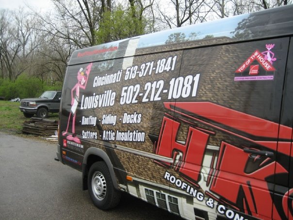

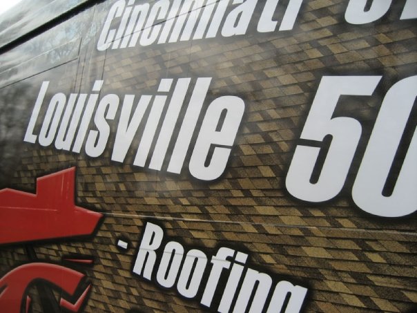

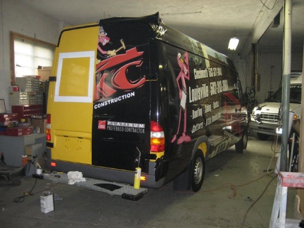

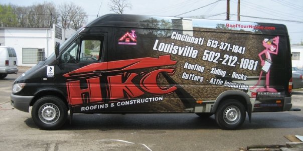

A few years ago Fellers was suggesting that you cover them with magnetic material then wrap over them. I always wondered if anyone actually did that.
I did it a few years ago, seemed like it worked good. Now I don't have to do my installs, and my installers do the regular install of cutting and dropping in.
