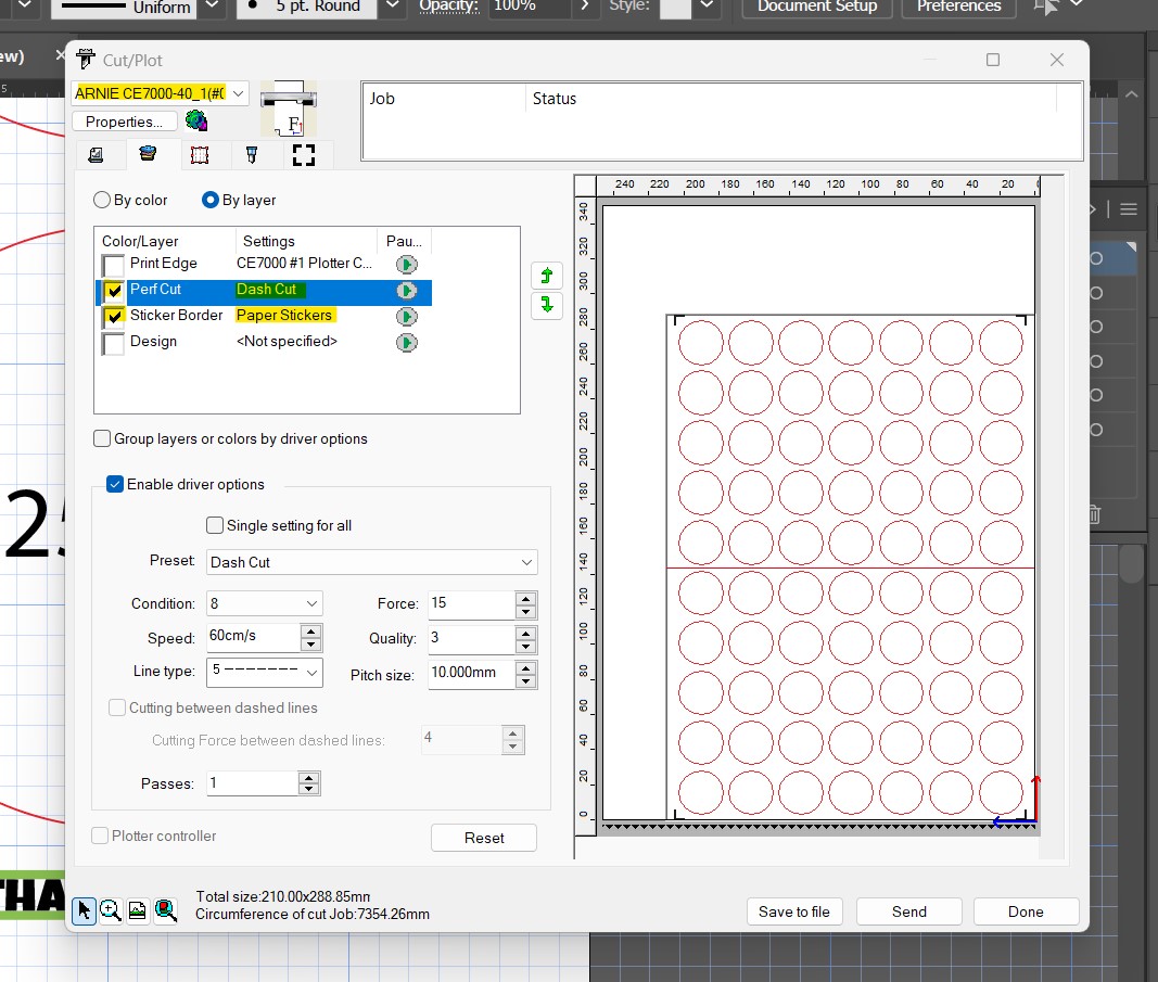

Hi , I am using cutting master 4 - I have two Graphtec plotters connected and they both work fine
when I change plotters it remembers the two ticks on the left selecting the perf cut and the sticker cut only and this works well.
What it doesn't do is remember the settings/conditions for the two different cuts and it goes back to default. If I just use the one plotter it is fine but as soon as I change plotters it forgets the settings.
All I am after is for the cut that goes horizontally along the page to be a different condition - dash cut and deeper cut - than the condition that is cutting my circles.
I can get it to do both but only if it is the same condition for the Middle cut and also the circles
