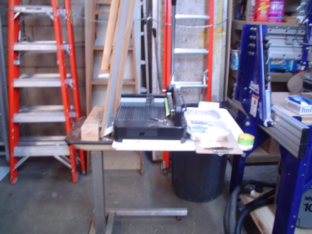

This- we bought a Chinese 12" guillotine for about $300 that will cut 30-40-50
at a time easily. Weighs a ton. The long table on the left folds down to take
6' stacks of stapled strips.
