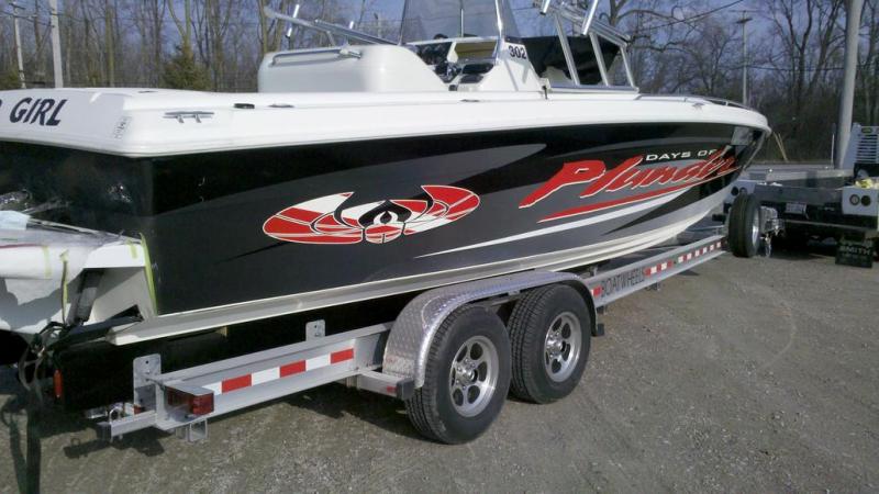

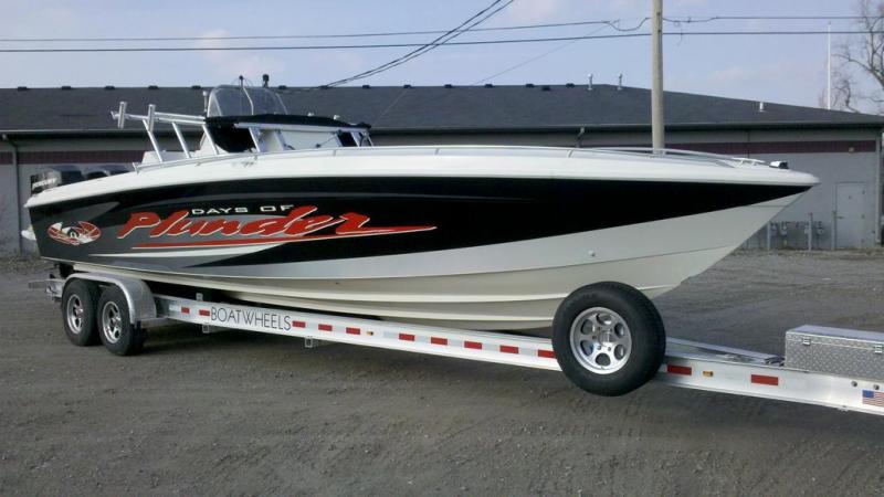

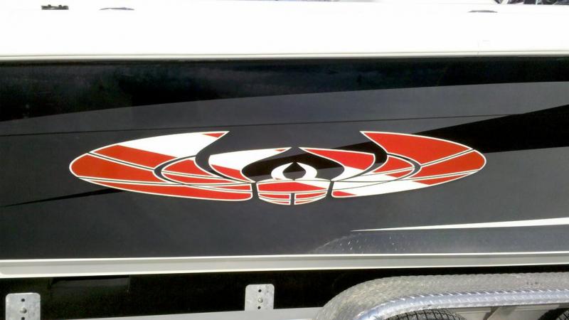

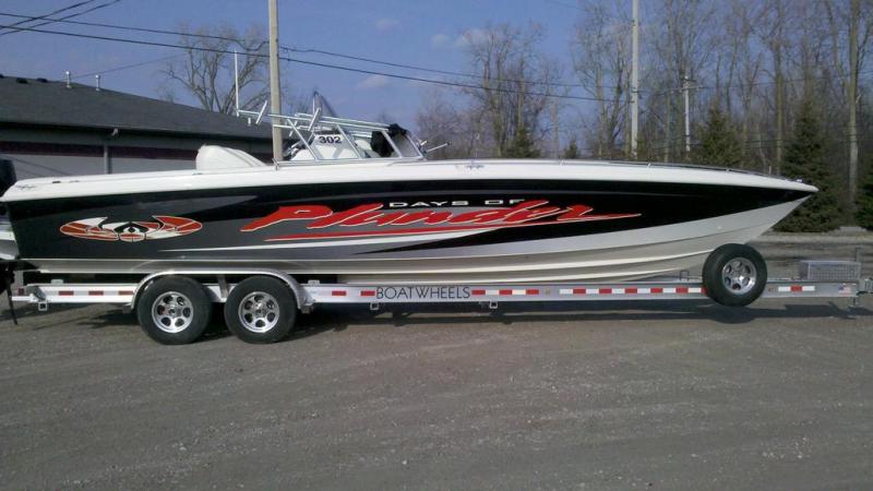

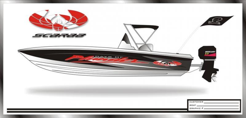

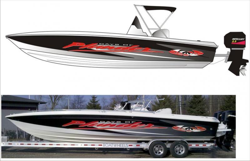

I only cut spray masks for custom paint jobs i do in the high perf boat biz (pic below is representative of what i do and its all paint) All my vector files, logos, etc i do from scratch and are tailored to the boat/customer so i really dont need a full sign shop type program, tried AI and Flexi but kept going back to Corel. For the most part i just do line management and custom line templates with maybe some color fills for renderings to customer.
