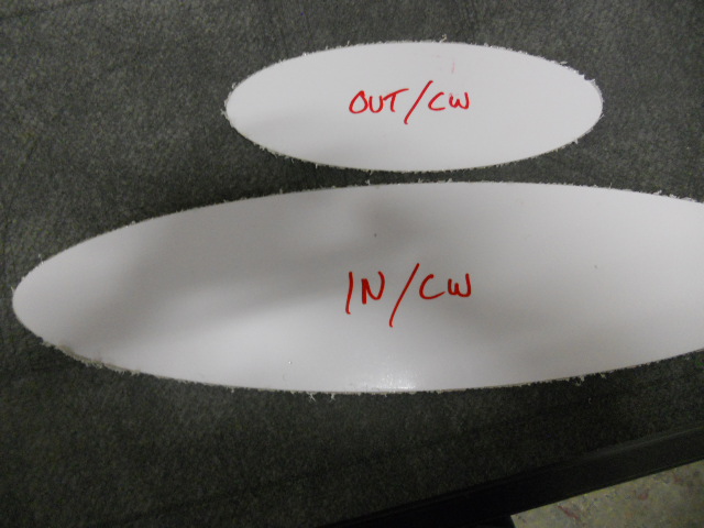

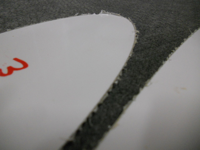

We are relatively new to cnc routing. I've attached a couple pics of the frayed edges. We used a Onsrud 63-618 bit relatively new.
Does the rpm and feed rate factor in? We cut this at 25000rpm and 200in/min feed rate.
These were test cuts with vinyl and laminate mounted onto alupanel.

Just wondering if you removed the protective plastic film on the substrate? From the pictures it looks like the fraying is really the film.

Old or incorrect bit, too slow feed and/or too fast rpm. If the bit is dull (happens pretty fast) then doesn't matter what you do you will get burrs. Too slow feed rate and the bit will continue to rub the already cut edge as it slowly moves resulting in burrs. Too fast RPMs will do the same thing, allow the bit to rub the already cut edge and raises a burr. So you want a pretty fresh bit, you want the fastest feed rate and slowest RPM possible without causing material shifts or bit breaks. If none of that is working then do a finish cut on it...i.e. cut the whole job but slightly larger than finished size (.02" or similar) and then do a second pass cutting to finished size. You can speed up feed rate and slow down RPM on finish cut because it's cutting such a small amount of material. In which case you would also leave a little "webbing" on the bottom i.e. don't cut the full depth on the first pass, leave a .02" or similar webbing on the bottom to hold everything together for the finish cut. This will help burring and also hold any small details in place for the finish cut. Since the webbing is so thin it won't cause any material shifts and is just enough to hold everything. You could also put transfer tape on the back side and just cut through the media leaving the transfer tape as the webbing. Hope it helps!

best way to stop the edges getting ragged is to use a revers spiral singel flute cutter, this pushes swarf down and away
unlike a normal cutter that pulls the swarf up and under the laminate
slow the cutter RPM down as much as you can, and adjust the feed rate also
do a lead in and lead out on the cut path, this will help on the finished shape
